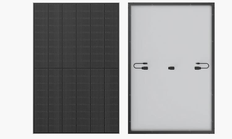

EcoFlow 400W Rigid Solar Panel
For a fixed rooftop array, the EcoFlow 400W Rigid Solar Panel suits homes with enough space for a full-size rigid module and a layout designed for permanent installation. Its high output per panel keeps module count more manageable, while the rigid aluminium frame and weather-resistant construction make it better suited to long-term exposure on a roof.
- 400W rated output - 23% conversion efficiency - Monocrystalline cells with an anti-corrosive aluminium frame - IP68-rated weather protection - 10-year workmanship warranty
