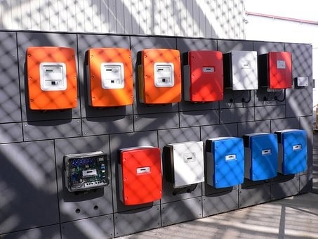

1. Choose a Power Inverter
Your home appliances use alternating current (AC) electricity to run. Unfortunately, batteries generate direct current (DC).
You can’t just connect a battery directly to your home circuit board or your appliances. You need to convert the battery power into AC — commonly known as household electricity.
The device that converts DC power to AC electricity is called an inverter.
When choosing an inverter, the first step is determining how much power output you need to produce. An inverter will carry a rating in watts, but unless you know the consumption required by the appliances and systems you want to run during a blackout, the wattage of the inverter is somewhat meaningless.
To determine your household energy consumption, add the wattage of each device and appliance you want to power or charge during an outage. For example, a 2000-watt inverter can only provide electricity simultaneously to appliances with a combined wattage of 2000W or less.
It’s also crucial to keep in mind that many appliances require a higher wattage to turn on than to operate. This is commonly referred to as surge power or starting watts. Make sure your inverter’s output capacity is sufficient to turn your appliances on, not just keep them running.

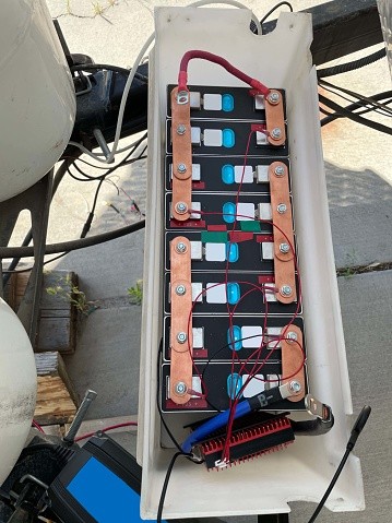

2. Choose Your Battery
Next, you need to choose your battery. You will probably need multiple batteries for a whole house backup power supply.
Battery capacities can range from small, 100Wh batteries to larger, 3.6kWh batteries sufficient to power large appliances. To find out how much power output and storage capacity you need, determine the wattage requirements of the appliances or devices you want to power, then multiply that number by the amount of time you want to be able to run it.
For example, running a 300-watt laptop for six hours would require a battery with a minimum power output of 300W and a storage capacity of 1800 watt hours (1.8 kWh).
If possible, select batteries that reach at least double the storage capacity you need so that you can keep them from discharging below 50% capacity.
Depending on the battery chemistry, “deep discharging” can negatively impact lifespan and performance.

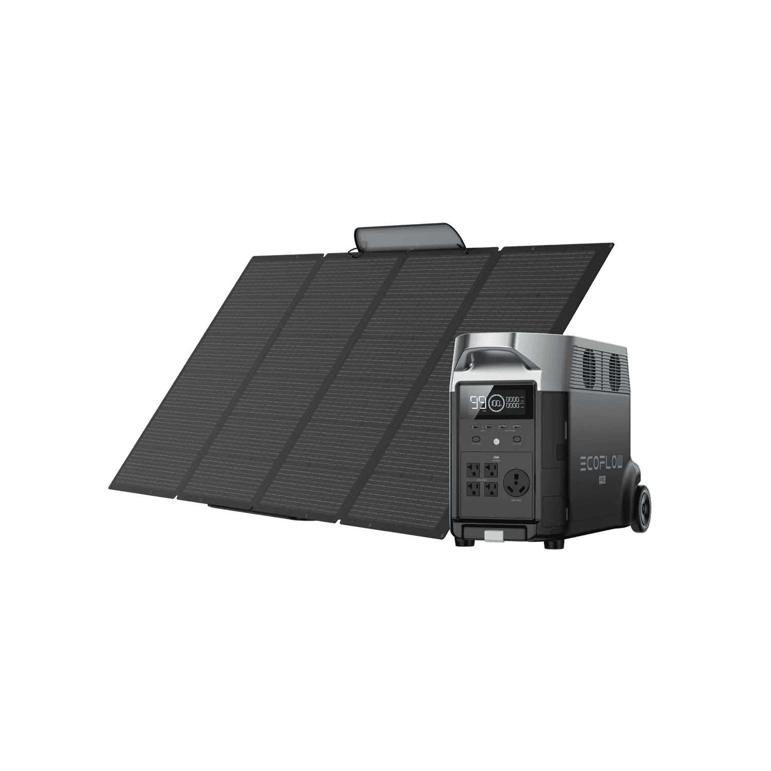

  • DELTA 2 Portable Power Station—The DELTA 2 power station delivers 1024Wh capacity. You can run several appliances and keep your essentials running during an outage.
  • DELTA Pro Portable Power Station—The Delta Pro can run major appliances and heating/cooling systems with a 3.6 kWh power output capacity (expandable to 7.2 kWh/240V). You can connect extra smart batteries and expand the storage capacity to 21.6 kWh for a whole home power backup solution that can run for up to a week.

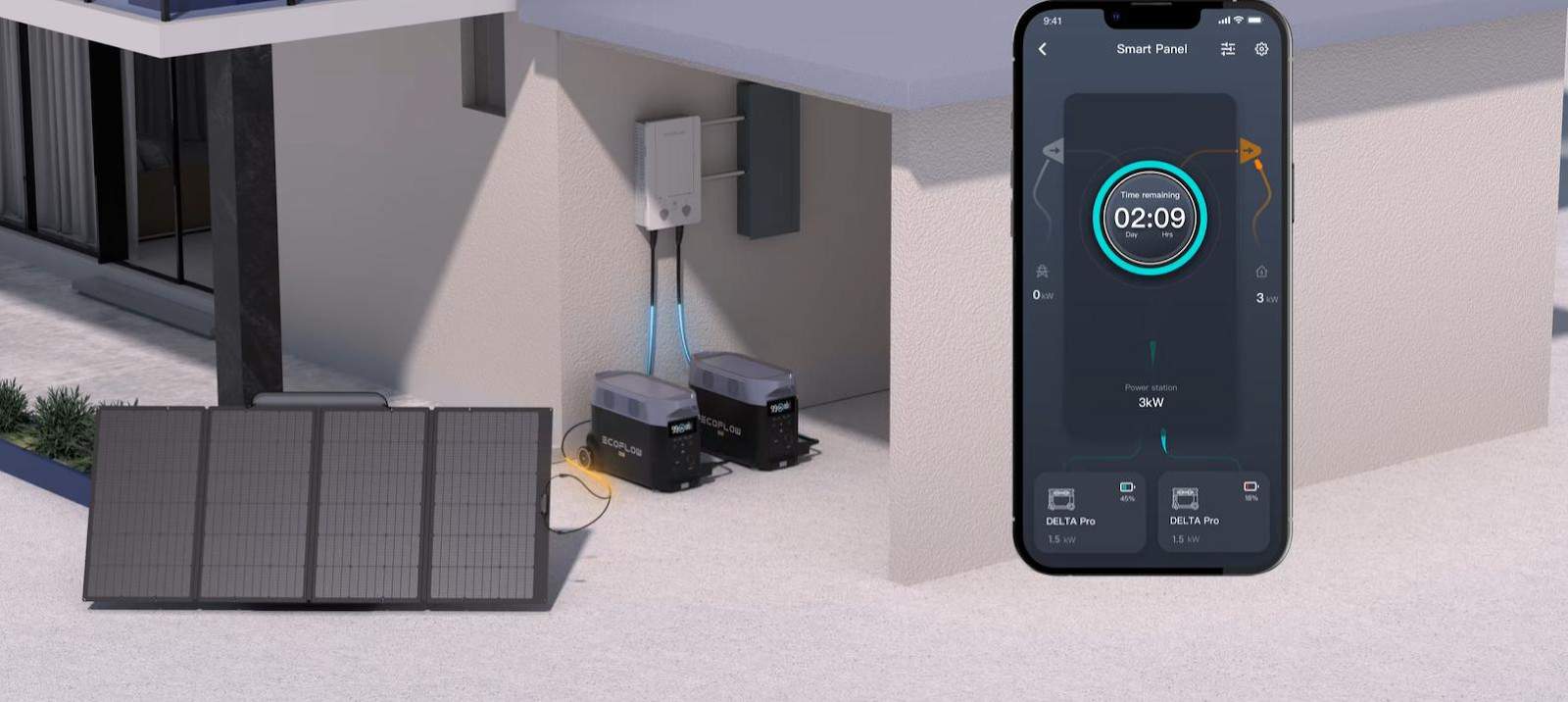

EcoFlow offers solutions to back up and power your entire home in a blackout. Or you can go completely off-grid with solar panels to achieve energy independence:
  • Whole Home Backup Power Solution: The EcoFlow advanced whole home backup power solution consists of two DELTA Pro Portable Power Stations connected via the EcoFlow Double Voltage Hub. By chaining two DELTA Pros together, you can achieve 7.2kWh of power output. Connect up to four smart extra batteries, and you can have up to 21.6 kWh of battery storage — which will last many homes up to a week. Connecting the whole home backup power solution to your home circuit panel creates a built-in backup system that can switch on instantly during a blackout and meet all your power demands.
    Also, don’t forget, all of EcoFlow’s portable power stations — including the DELTA Pro — can recharge using solar panels. Turn your backup battery into a solar generator with one simple connection.
