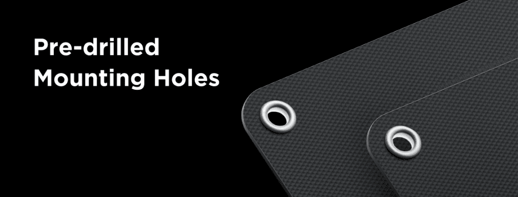

With EcoFlow’s flexible solar panels, there are two easy installation methods. One is to screw them directly onto the exterior of your motorhome using a drill or screwdriver. The PV panels come with six pre-drilled holes — one in each corner and 2 in the middle on either side of the frame.

Screw Mounting: Position the solar panel where you want it mounted. Using a pen or marker, make a marker through each of the predrilled holes in the panel. Use the appropriate sized drill bit to predrill your holes on the motorhome. Screw your panel into the holes on the motorhome using a screwdriver or power drill and the right size Phillips or flat head screws. It’s usually best to screw in the diagonally-opposite corners first, as this will help ensure the panel stays in place as you screw in the other holes.
