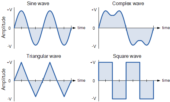

How Does a Solar Inverter Work?
A solar inverter uses solid-state components to convert DC to AC electricity.
Unlike older technologies like mechanical inverters, solar inverters have no moving parts. Instead, they utilise power semiconductors, like transistors and diodes, to switch direct current on and off at a very high frequency.
(Source: Electronics Tutorials)
Rapid binary switching produces alternating current — ideally with a pure sine waveform. Pure sine electricity is considered the gold standard of AC waveforms because it is “clean” and free of the distortion and noise that can harm sensitive electronics when inferior inverters are used.

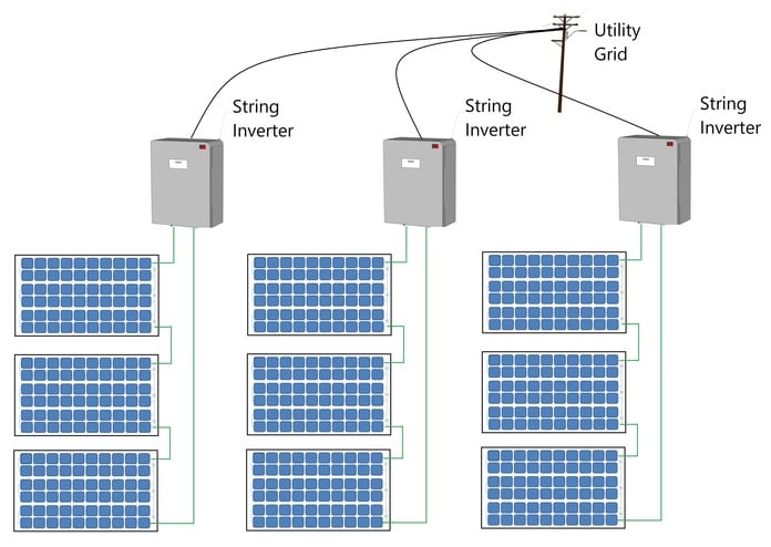

String Inverters
String inverters are the oldest and most common type of solar inverters for small systems in the 500-watt to 3kW range. They are often used in portable and residential applications.
The principle behind string inverters for photovoltaic arrays is the same regardless of the installation’s scale.
In grid-tied systems, solar panels connect directly to each other and transmit their combined DC electricity to the string inverter.
The string inverter converts DC to AC electricity, transmits it to your home for immediate consumption, or, through a bidirectional or smart meter, sends the electricity to the grid.
If you enrol in the Smart Export Guarantee (SEG) scheme — similar to the now discontinued Feed-in Tariff — you can receive cash or credit against your electricity bills for excess electricity that your solar power system produces.
In off-grid or hybrid solar systems, PV modules may send DC electricity to a solar charge controller first. However, the solar inverter is still an integral part of the balance of the system.
Benefits of String Inverters
- Easy to set up
- Low-cost
- Up to 98% efficiency
- Low maintenance
- Easy to monitor

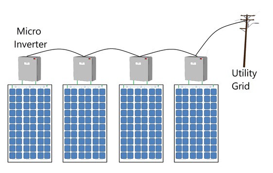

Microinverters
Microinverters — also known as module inverters — are generally built into photovoltaic modules.
In a solar panel array that utilises microinverters, each individual panel has a small dedicated inverter located on an underside made of non-photovoltaic material.
Benefits of Microinverters
- If one solar panel is shaded for part of the day, it will not affect the performance of the entire array, as it can with a string inverter
- Individual multi-point power tracking (MPPT) capability
- Scalability
- Minimal wiring costs
- Performance monitoring of individual panels

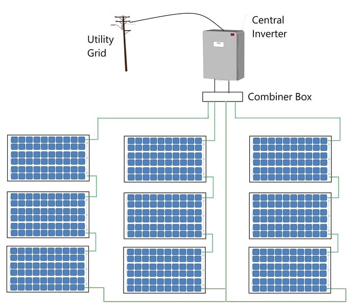

Central Inverters
A central inverter utilises multiple strings of solar panels that connect to a power conditioning combiner box before delivering DC electricity to the inverter.
Rather than using a separate inverter for each string or panel, one DC output from the combiner connects to the central inverter, which converts DC to AC and delivers to your home and the utility grid from a single output.
Central inverters are typically deployed in large solar power systems in the 5kW – 100MW range.
Benefits of Central Inverters
- Easy to design and implement
- Cost-effective
- Simplified maintenance and troubleshooting
(Source: Penn State)

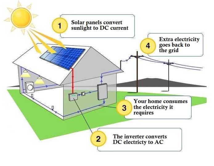

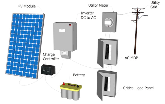

Grid-Tied Solar Inverters

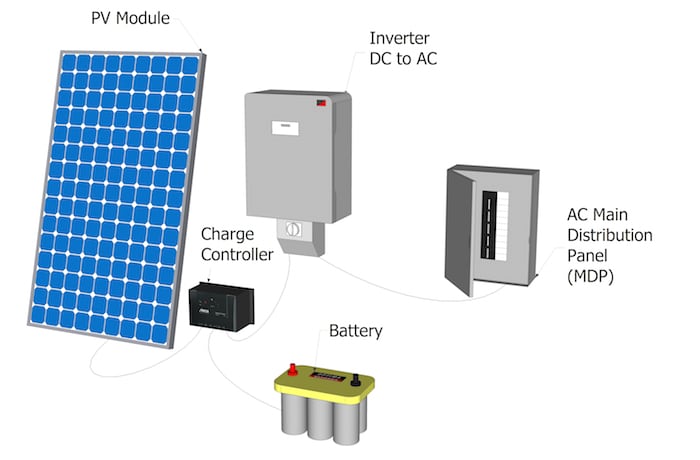

In a grid-tied system, DC electricity from photovoltaic modules like solar panels is transmitted through cables directly to a solar inverter. The solar inverter converts DC to AC electricity for consumption in your home and transmission to the utility grid.
(Source: ResearchGate)
Off-Grid Solar Inverters

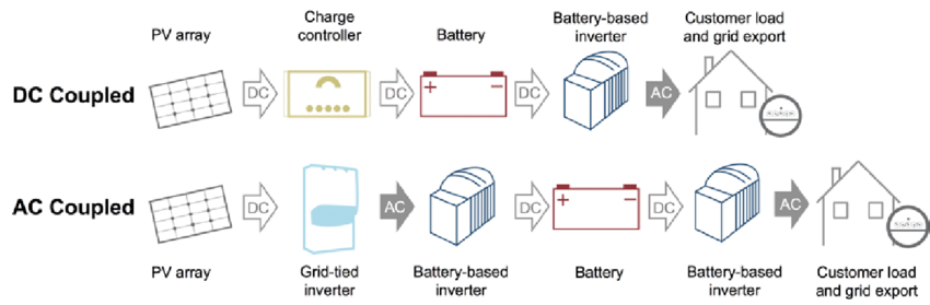

Off-grid solar power systems use solar batteries to store electricity to solve the problem of intermittency. Because off-grid systems operate independently of the utility grid, electricity must be stored for consumption during the night or at other times when your household consumes more power than your solar panels produce.
In an off-grid system, solar panels transmit DC electricity to a solar charge controller, which distributes power to a solar battery or a solar inverter, depending on whether the priority is consumption or storage.
Hybrid Solar Inverters
In some ways, a hybrid system offers the best of both worlds. It allows you to toggle between utility grid and solar battery storage automatically, depending on the parameters you set.
Most crucially, a hybrid solar + storage system provides electricity during a blackout. Depending on your solar battery capacity and electricity production potential, you can have power during even extended outages — or indefinitely.

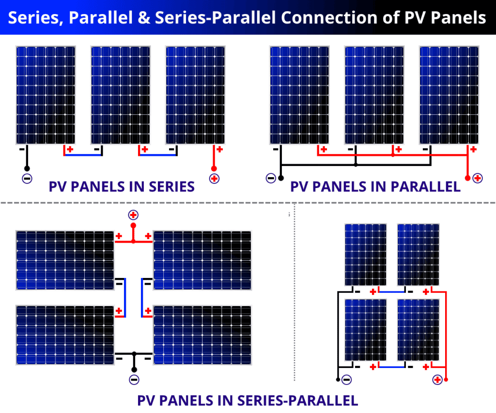

Connecting Solar Panels to an Inverter
There are three different methods of stringing solar panels together and connecting them to the solar inverter or charge controller (for off-grid and hybrid systems.)
(Source: Alternative Energy Tutorials)
Connecting Solar Panels of the Same Model and Rated Power in Series
To connect your solar panels in series, wire the positive terminal to the negative terminal of each panel in the array. At the end, you’ll have a single positive/negative connection that will plug into your balance of system.
By wiring your solar panels in series, the output voltage of the array accumulates. In the diagram above, the output voltage of each panel is 6 volts. At the end of the series, the cumulative output is 18V (3 panels x 6V = 18V).
What’s crucial to note is that while the voltage output increases with each panel added to the series, the amperage remains the same.
Series connections are typically used for grid-tied systems that require a voltage of 24V or more.
Advantages
Voltage Accumulation: If your installation requires high voltage to operate — standard with on-grid systems — series or hybrid series/parallel wiring is probably essential. Even if it’s not, if your application is best served by higher voltage rather than amperage, a series connection is your best choice.
Efficiency and Performance: Without considering other factors, series connections will output slightly more electricity from the PV panel array than other wiring methods. There is less power lost delivering electricity over distance to your balance system in a series connection.
Thinner Cables: A relatively minor consideration, but parallel connections require higher gauge wiring due to how the electricity is transmitted. Series connections may cost slightly less to wire the same number of panels.
Better for Distance: Depending on the total surface area of your installation and how long the cables must be to connect to your balance of system, series connections may deliver an additional benefit. Voltage travels more efficiently than amperage over long distances.
Disadvantages
Obstruction and Shading: The most significant disadvantage of wiring solar panels in series is that the output of the entire array is dependent on the individual production of each module.
If you have 20 solar panels with a rated voltage of 6V each, the maximum potential output during peak sun hours is 120V. However, if just one module is in the shade (or damaged) and only produces 4V, the array’s output will be reduced to 4V per panel. Instead of 120V of production, your panels will output 80V. If part of your installation area suffers from significant shade during peak sun hours, you should consider parallel or hybrid connections instead.
Danger: High Voltage: There are many benefits to increasing the voltage output of your solar panel array. However, high voltage can be dangerous or deadly if improperly used. Working with high voltage also dramatically increases the risk for the person doing the installation. If you decide to proceed with a series connection, it’s best to hire a
professional installer.

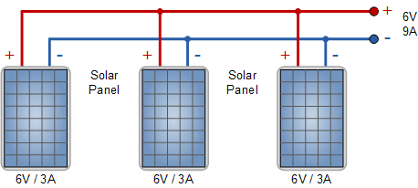

Connecting Solar Panels of the Same Model and Rated Power in Parallel
To wire solar panels in parallel, connect each panel’s positive terminals together. You also connect all the negative terminals to one another. Parallel wiring results in amperage accumulating and voltage remaining the same. The exact opposite effect of series wiring.
Again, using the same panels in the series example above, if the amperage per panel is 3V and you have 3 identical panels, your total output will be 9 amps (9A) and 6 volts (6V). The formula looks like this:
3A x 3 PV panels = 9A total output
Voltage doesn’t increase — the output remains 6V no matter how many solar panels you connect. If you have a 20-panel array connected in parallel with 6V/3A of rated power output, your maximum electricity production capacity is 6V/60A.
Advantages
Cumulative Increase in Current: Each PV panel you add to an array connected in parallel adds its direct current output to the system’s total output.
Less Overall Vulnerability to Shade: Unlike the voltage produced by series connections, the increased amperage (current) produced by parallel connections is not dependent on the performance of individual panels. If one PV panel is covered in shade for part of the day, the performance of the entire array is not affected. Shaded panels will contribute less current to the total output, but the maximum output of the panels receiving direct sunlight remains the same.
For example, if you have 20 panels that output 3A of current in peak sunlight, but two are covered in shade, reducing their output to 2A, the cumulative output of your array will be reduced by 2A. The total (theoretical) output is 58A instead of 60A because each shaded panel produces 1A less.
For many rooftop installations, the advantage of parallel wiring is obvious. Depending on your location and roof structure, substantial portions of your solar panel array may be regularly shaded by obstructions like trees and neighbouring buildings for part of the day.

Constant Voltage: Unlike series connections, you can add additional PV panels without increasing the voltage. This makes parallel connections invaluable in applications that require 12V power input, like many motorhome and recreational vehicle systems.
Similarly, solar inverters have a maximum voltage capacity. You can add more PV panels to your array and continue using the same inverter. If you wired the same array in series and exceed the voltage capacity of your inverter, it will either shut down or permanently damage the component.
Disadvantages
Less Efficient: The larger your solar panel array, the more power you will lose to inefficiency. Parallel wiring leaks more energy over long distances than series connections.
Less Resistant to Heat: Believe it or not, solar panels suffer in the heat. Direct sun exposure is optimal for electricity production, but solar panel efficiency declines rapidly as the temperature rises above 25°C.
That’s because the photovoltaic effect used by solar cells captures energy from sunLIGHT, not from heat.
All solar inverters and balance of system components like PWM or MPPT charge controllers have minimum voltage requirements. If heat (or other factors) hinder solar panel efficiency to the degree that voltage output decreases below the minimum requirement, adding more PV panels wired in parallel will not solve the problem.
Thicker, More Expensive Cables: Amperage (current) flows through wires in a similar way to how water flows through a hose. The more current (water) you want to output, the bigger the cable (hose) has to be. Larger gauge wires are also less efficient at moving current over long distances. Parallel connections are typically better suited to smaller installations.
Series-Parallel Connections (Hybrid)
Connecting solar panels in series or parallel each has its pros and cons.
Can you have the best of both worlds?
Yes, many professional sizeable solar panel installations combine series and parallel wiring in one array to maximise the product of each group of panels.
It’s possible to strike the optimal balance between series and parallel wiring by carefully planning the wiring based on the location of the panels on the roof relative to the sun and obstacles that obstruct sunlight at certain times of day.
Typically, the goal is to achieve the right balance of producing volts and producing amps by wiring panels together in series and in parallel — not either/or.
If your residential solar installation will have more than 3 or 4 PV panels, it’s best to work with a professional installer. It will cost you more upfront but should substantially increase your return on investment and shorten your solar payback period.
For safety and performance reasons, we highly recommend that you DO NOT attempt hybrid series-parallel wiring of your solar panels on your own. Work with a reputable installer to achieve optimal results.
Some of the factors a solar power professional will consider when developing a wiring plan include.
