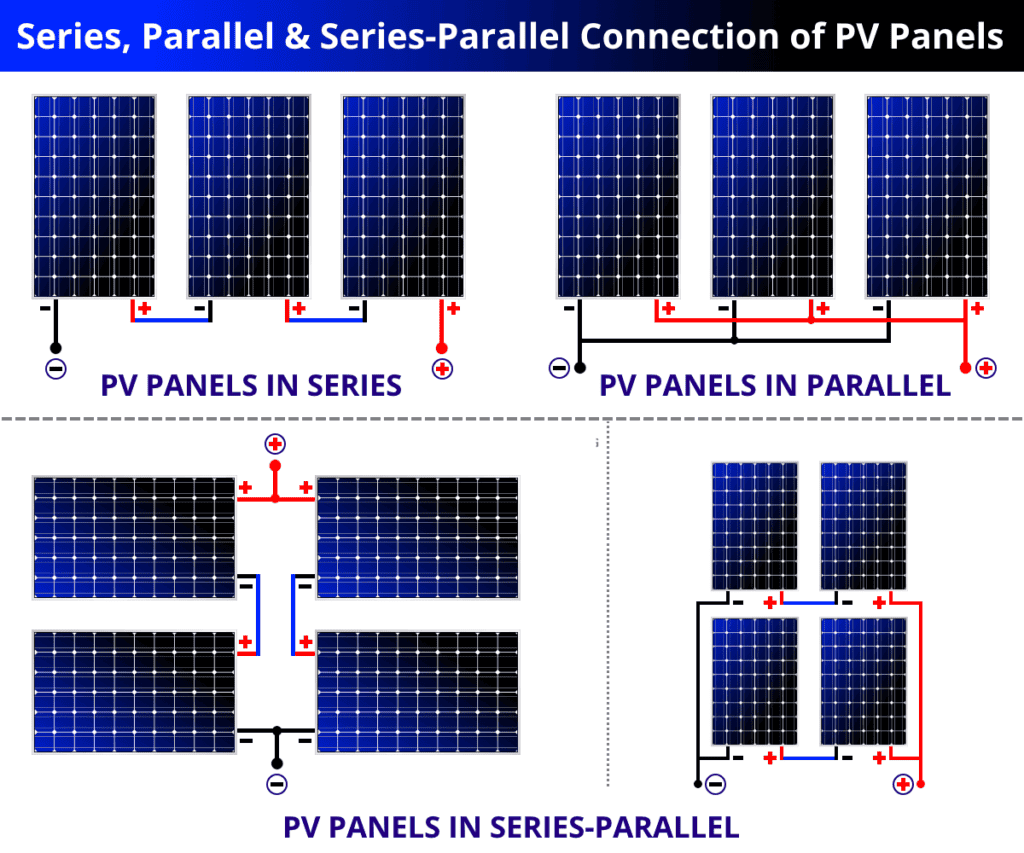

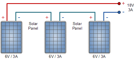

Series Wiring
To connect solar panels of the same model and rated power in series, wire the positive terminal to the negative terminal of each panel in the array.
At the end of the chain, you’ll have a single positive/negative output to plug into your balance of system.
By wiring your solar panels in series, the output voltage of the array accumulates.
In the diagram above, the output voltage of each panel is 6 volts. At the end of the series, the cumulative output is 18V (3 panels x 6V = 18V).
What’s crucial to note is that while the voltage output increases with each panel added to the series, the amperage remains the same.
Series connections are typically used for grid-tied systems that require a voltage of 24V or more.
(Source: Alternative Energy Tutorials)

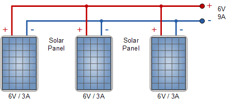

Parallel Wiring
To wire solar panels in parallel, connect each panel’s positive terminals together.
You also connect all the negative terminals to one another.
Parallel wiring results in amperage accumulating and voltage remaining the same. The exact opposite effect of series wiring.
Again, using the same panels in the series example above, if the amperage per panel is 3V and you have 3 identical panels, your total output will be 9 amps (9A) and 6 volts (6V). The formula looks like this:
3A x 3 PV panels = 9A total output
Voltage doesn’t increase — the output remains 6V no matter how many solar panels you connect. If you have a 20-panel array connected in parallel with 6V/3A of rated power output, your maximum electricity production capacity is 6V/60A.

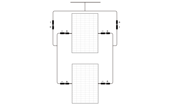

Hybrid Setups (Series-Parallel)
Connecting solar panels in series or parallel has its pros and cons.
Can you have the best of both worlds?
Yes, many large solar panel installations combine series and parallel wiring in one array to maximise the product of each group of panels.
It’s possible to strike the optimal balance between series and parallel wiring by carefully planning the wiring based on the location of the panels on the roof relative to the sun and obstacles that obstruct sunlight at certain times of day.
Typically, the goal is to achieve the right balance of producing volts and producing amps by wiring panels together in series and in parallel — not either/or.
If your residential solar installation will have more than 3 or 4 PV panels, it’s best to work with a professional installer. It will cost you more upfront but should substantially increase your return on investment and shorten your solar payback period.
For safety and performance reasons, we highly recommend that you DO NOT attempt hybrid series-parallel wiring of your solar panels on your own. Work with a reputable installer to achieve optimal results.
Some of the factors a solar power professional will consider when developing a wiring plan include.

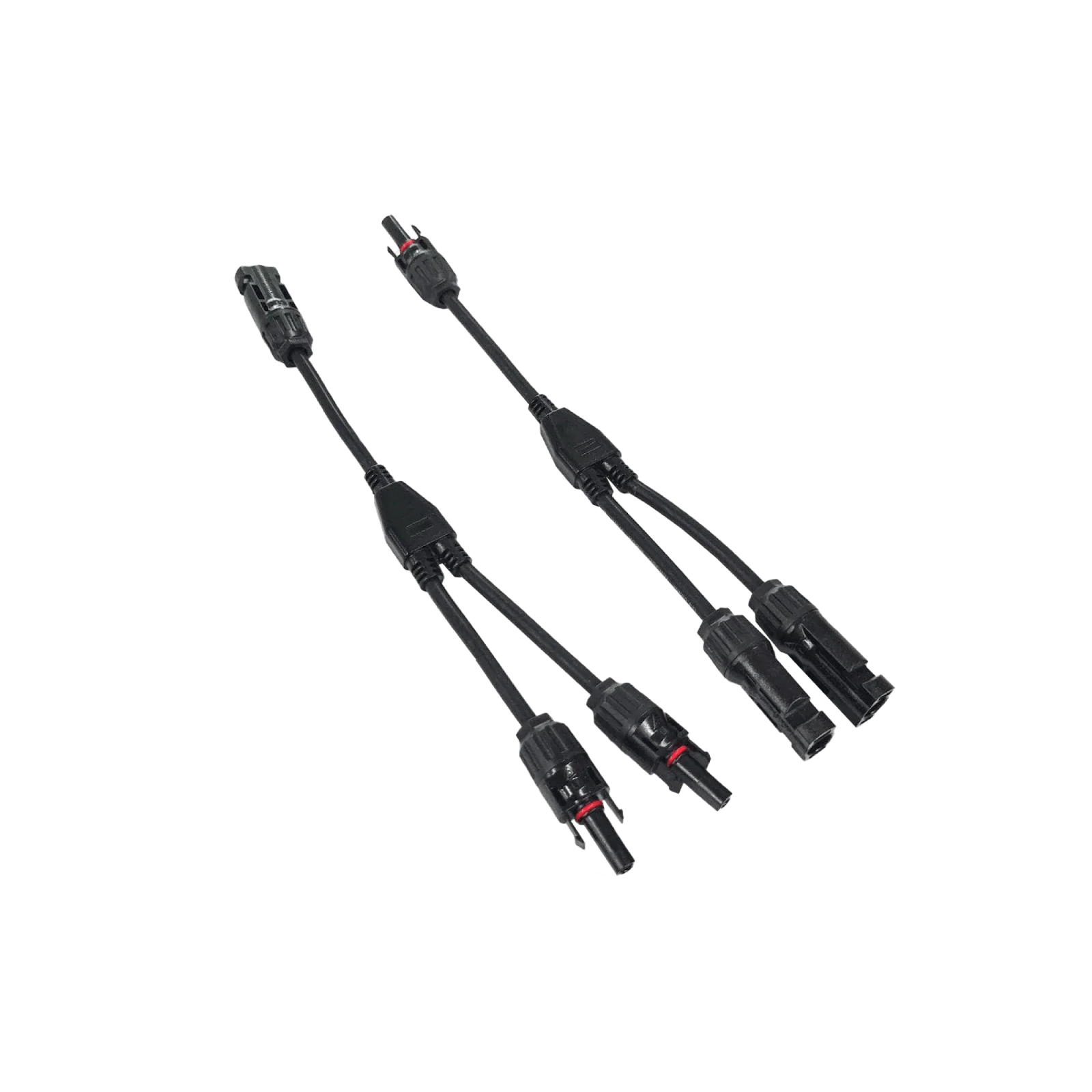

Decide whether to connect your solar panels in series, parallel, or series-parallel. Parallel is often best for small systems of 2 or 3 PV panels. However, you must evaluate the optimal option for 4 x 400W rigid solar panels based on your location and other relevant conditions.

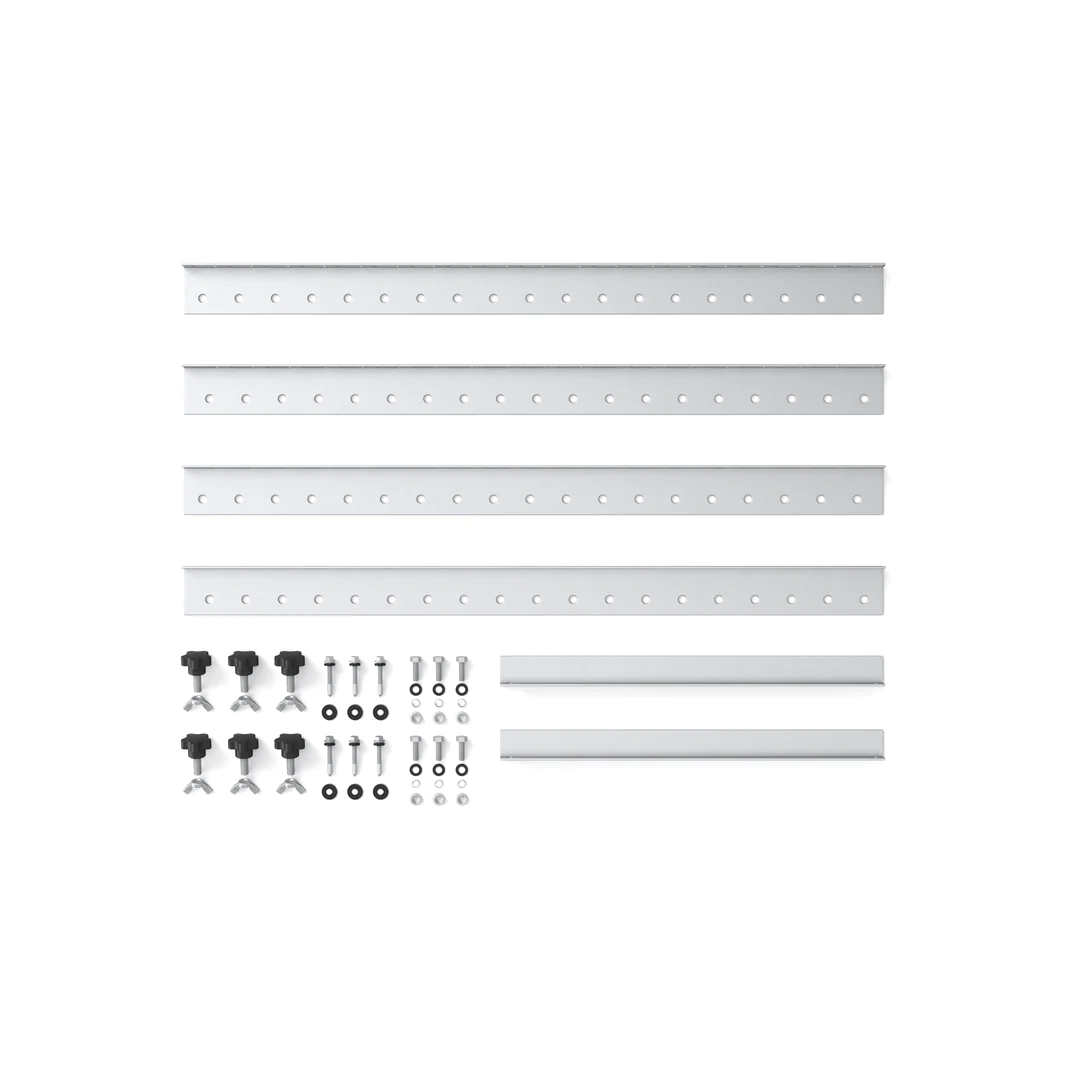

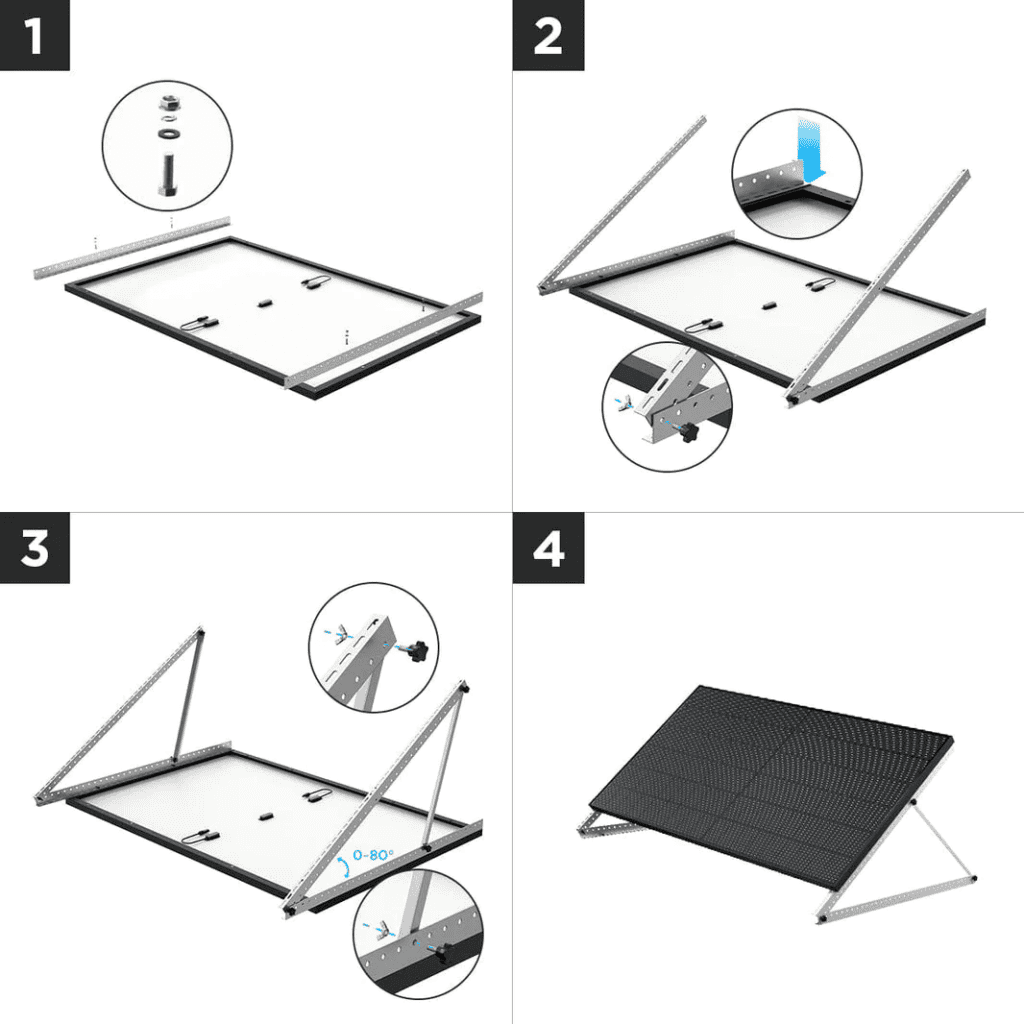

Step 3: Assemble Your Mounting Hardware
EcoFlow’s rigid solar panels come with 4 x solar mounting feet. But unless your roof is perfectly angled for maximum sunlight exposure, you will need additional hardware.
You can purchase optional EcoFlow 50” Tilt Mount Brackets directly from the manufacturer’s website. The 50” (127cm) Tilt Bracket is specifically designed to make mounting your 400W rigid solar panels on a rooftop (or any other flat surface) incredibly easy.
All you need is the following tools:
- Adjustable wrench (M8 and M12)
- Tape measure
- Safety glasses
- Work gloves
If you prefer a different method of mounting your panels, such as a racking system, EcoFlow 400W rigid solar panels are designed to work easily with most third-party mounting systems.
The Tilt Bracket is simply a painless option for mounting your PV panels and positioning them optimally on your roof.
Detailed assembly instructions are included with the brackets. Anyone with even minimal DIY experience can assemble this mounting hardware.
Just be careful up on the roof!

EcoFlow 400W Solar Panels weigh 21.8kg and have dimensions of 172.2cm × 113.4cm ×3.5cm. That’s a lot of bulk for one person to carry up a ladder safely.
Using the tilt brackets will add a bit of weight but may make the panels more manageable to carry.

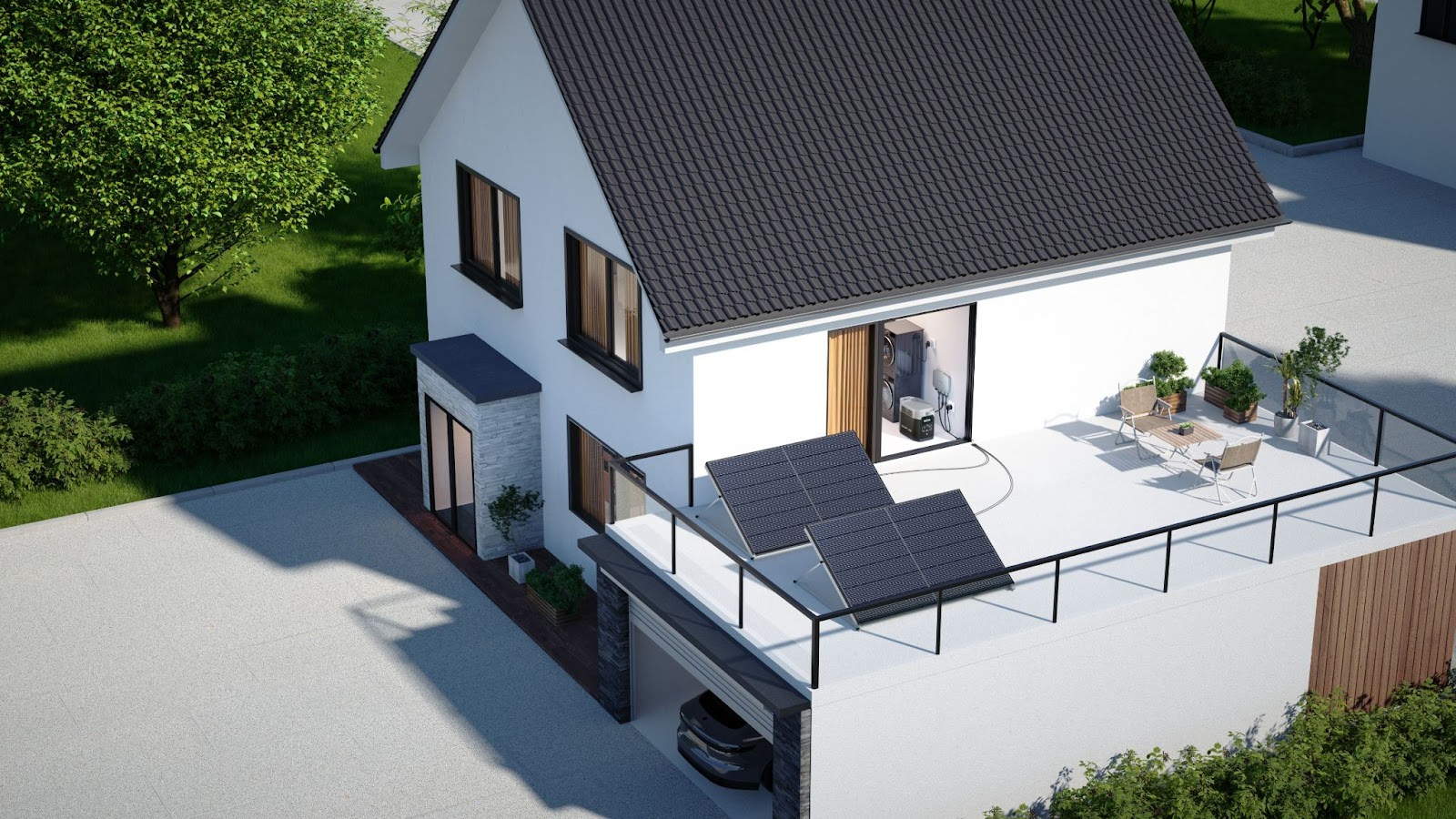

Once you have all four panels on the roof, arrange them in the configuration you mapped out in Step 1.
Double-check again (with the panels on the roof) that your wiring plan is correct. The panels should be as unobstructed as possible by buildings, trees, and other obstacles that regularly blot out sunlight during the day.
The surface area of each panel is approximately 1.95 m2, and you should aim to leave between 15 and 20 cm of space between each module.
Additionally, you’re advised not to mount solar panels any closer to 31cm from the edge of your roof. There may even be building code requirements for minimum distance from the roof’s edge in your location.
Given the above factors, the approximate total surface area required for installation is about 10m2, allowing for 20cm spacing between panels.
Once satisfied that your positioning is optimal, secure the tilt mounts or mounting feet to the roof according to your roof type and the instruction manual.
Step 5: Connect Solar Panels in Series or Parallel
During Step 1, you should have already decided whether you’ll benefit most from connecting your PV panels in series or parallel.

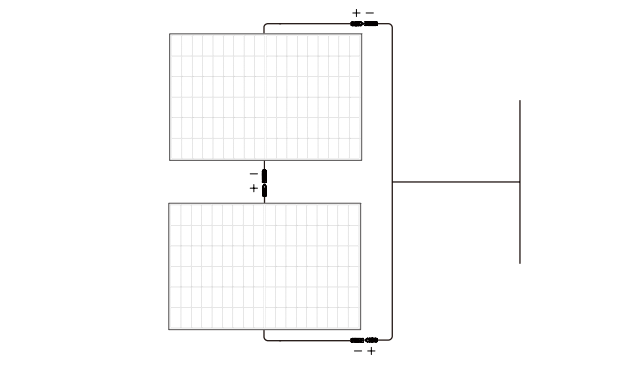

Series Connection
For series connection, connect the positive pole of one module to the negative second, third and fourth modules correspondingly. A series connection between 4 solar panels could quadruple the voltage. Amperage and wattage output remain the same.
For relatively small installations like this one, connecting the panels in series is recommended. Since the surface area required for installation is only 10m2, it’s unlikely that the performance of one solar panel will diminish the performance of the other 3 modules.
Parallel Connection
For parallel connection, please connect the positive and negative cables of one module and the second module correspondingly. A parallel connection between 4 solar panels could quadruple the amperage. Voltage and wattage output remain the same.
If you’re worried about the current being too low, consider wiring the four PV panels in parallel. With a four-panel array, there’s no benefit to wiring it in series-parallel.

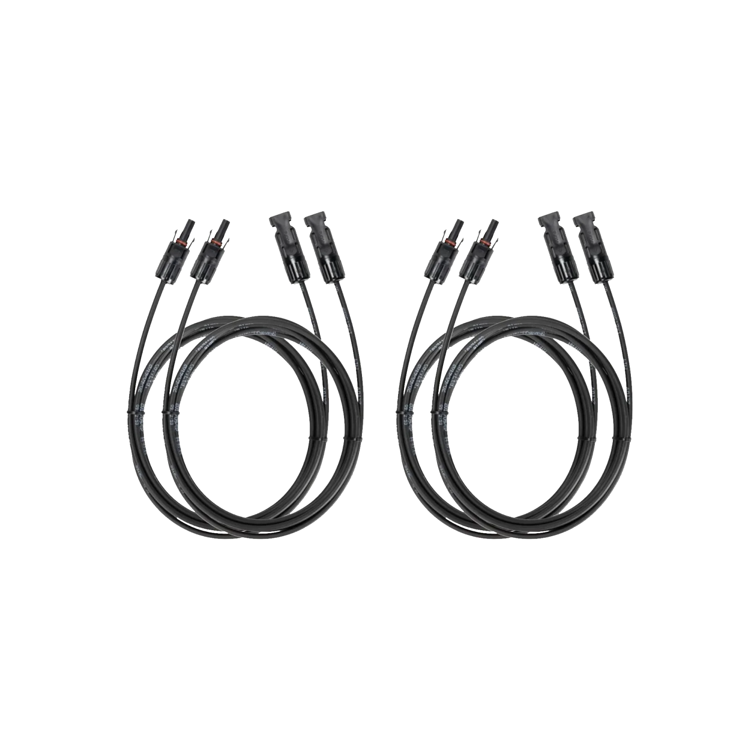

Whether you opt for series or parallel, you’ll require additional cables. The exact number depends on your installation, but you’ll likely need several solar extension cables.
If you’re wiring the panels in parallel, you also need solar parallel connection cables.

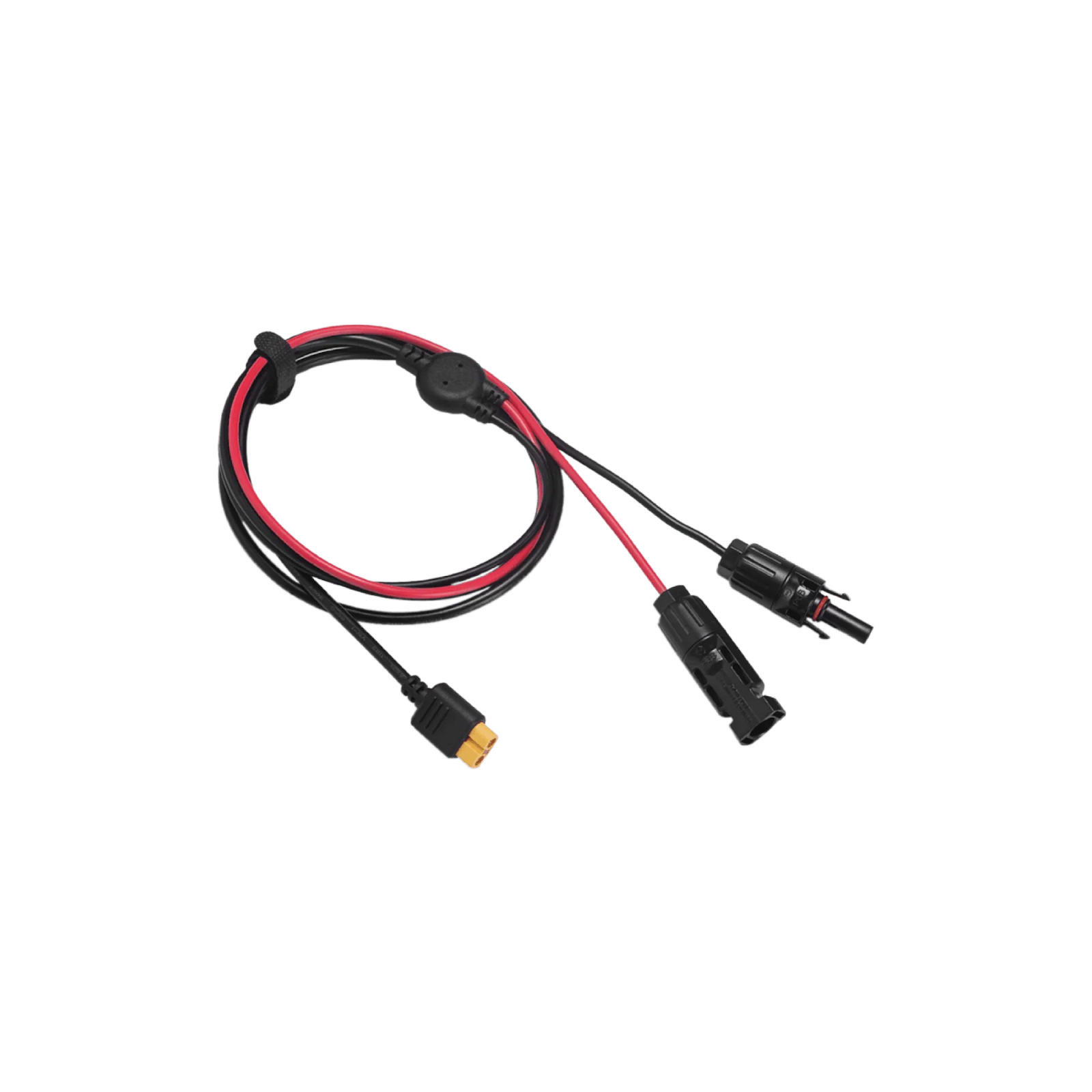

Step 5: Connect Solar Panels to Your Portable Power Station (Inverter)
Once your solar panel array is connected in series or parallel, you have one final connection to make.
Using an EcoFlow Solar to XT60/XT60i Charging Cable, connect the panel closest to the EcoFlow DELTA Pro portable power station. The EcoFlow DELTA Pro is not waterproof and must be sheltered in weatherproof conditions. The XT60/XT60i Charging Cable comes in 3m and 5m lengths. If your cable run is longer than 5m, you will need an extension cable.
Remember to keep the distance between the closest panel in your array and the EcoFlow DELTA Pro as short as possible. The longer the cable, the more electricity will be lost in transmission. The shorter the connection, the more efficient it will be.
Now, just plug the XT60/XT60i charging end of the cable into your EcoFlow DELTA Pro.

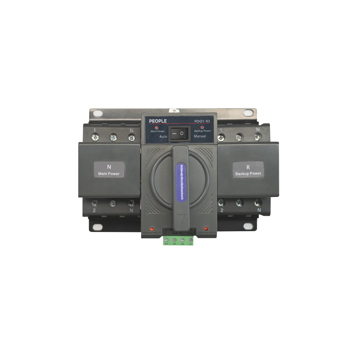

The good news is it’s a relatively quick job for a professional. First, you’ll need to purchase a transfer switch or EcoFlow Smart Home Panel.
A transfer switch is a device that switches a load between on-grid power and home backup power. The electrician will integrate the transfer switch with your main circuit panel. Then, you simply plug in the EcoFlow DELTA Pro for instant home backup (Transfer Time 1~2s).

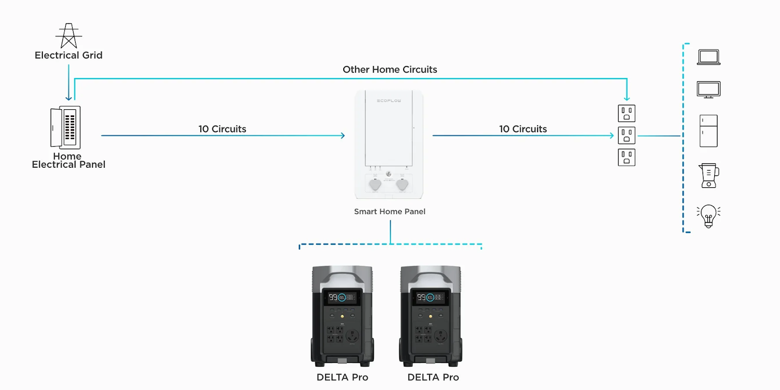

A transfer switch more than gets the job done. But if you want to take control and optimisation of your home backup system to the next level, consider the EcoFlow Smart Home Panel. It gives you unprecedented monitoring and control of your home backup solar power system — from anywhere with an internet connection.
When the grid is operational, you can connect up to 2 x EcoFlow DELTA Pros and get up to 3400W of fast-charging power. Adding a second EcoFlow DELTA Pro allows you to double your solar input capacity to 3200W and install up to 8 x 400W solar panels.
Remote control and extensive customisation options through the EcoFlow smartphone app mean you can minimise your electricity consumption from the National Grid.

When you wire in series, you combine the electrical pressure (voltage) of all of your panels while the rate of flow (amperage) remains constant.
On the flip side, when you wire in parallel, the amps add up, but the voltage does not.
You increase the flow rate but not the pressure.
