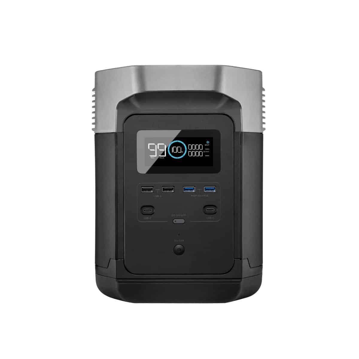

Why are the icons on the LCD screen dim?
Place DELTA on a hard surface.
