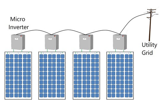

Microinverters
Microinverters — also known as module inverters — are generally built into photovoltaic modules.
In a solar panel array that utilises microinverters, each individual panel has a small dedicated inverter located on an underside made of non-photovoltaic material.
Benefits of Microinverters
- If one solar panel is shaded for part of the day, it will not affect the performance of the entire array, as it can with a string inverter
- Individual multi-point power tracking (MPPT) capability
- Scalability
- Minimal wiring costs
- Performance monitoring of individual panels

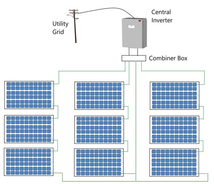

Central Inverters
A central inverter utilises multiple strings of solar panels that connect to a power conditioning combiner box before delivering DC electricity to the inverter.
Rather than using a separate inverter for each string or panel, one DC output from the combiner connects to the central inverter, which converts DC to AC and delivers to your home and the utility grid from a single output.
Central inverters are typically deployed in large solar power systems in the 5kW – 100MW range.
Benefits of Central Inverters
- Easy to design and implement
- Cost-effective
- Simplified maintenance and troubleshooting

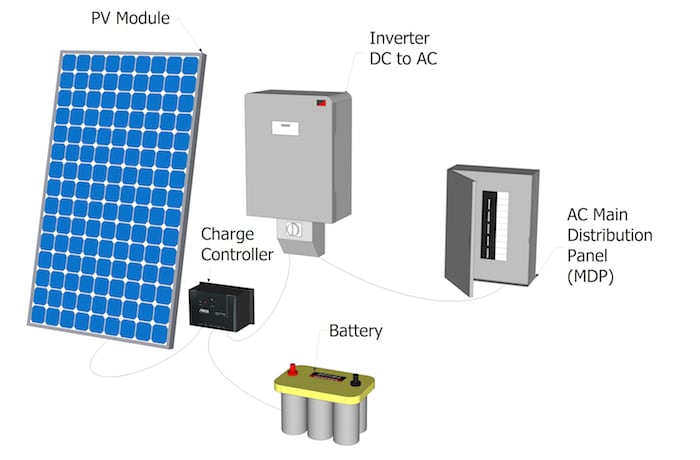

Off-Grid Inverters
Off-grid solar power systems operate independently of the utility grid and rely on battery storage to function during hours when there’s little to no sunlight.
Solar energy is intermittent by nature. Electricity production diminishes on cloudy days, and solar panels don’t work at night.
Grid-tied systems don’t require storage because they toggle between utility and solar electricity automatically. However, on-grid systems without solar batteries don’t work during a blackout.
Off-grid systems of sufficient size offer complete energy security, and solar batteries are an essential component.
Unlike grid-tied systems without storage, the first stop for electricity after it’s produced by solar panels isn’t an inverter. Instead, a solar charge controller is first in the chain.
There are two types of solar charge controllers: Maximum Power Point Tracking (MPPT) and Pulse Width Modulation (PWM). Both alternate between supplying DC electricity to a solar battery for storage or to an inverter for conversion to AC.
Benefits of Off-Grid Inverters
- Battery storage can provide energy independence and security
- Electricity bill savings
- Better return on investment over time
- Can shorten the solar payback period

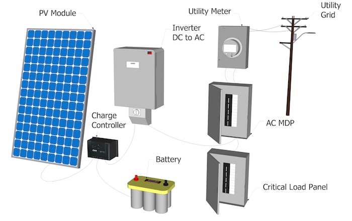

Hybrid Inverters
The term “hybrid” can refer to several different types of residential solar power systems, including installations that utilise wind power in addition to PV-generated electricity.
Here, we’ll focus on hybrid systems that offer solar power + storage.
A grid-tied solar power system without storage offers benefits like lower electricity bills and a reduced carbon footprint. However, on-grid PV systems that don’t have a solar battery will not provide electricity during a power outage.
Because a grid-tied system both transmits and consumes electricity from the power grid, it must shut down automatically during a blackout. Otherwise, electricity sent from a PV system could injure or kill workers trying to restore power or cause further damage to electricity infrastructure.
A correctly configured hybrid solar panel system will work during load-shedding and unscheduled blackouts.
Benefits of Hybrid Inverters
- Provides energy security by remaining operational during a power outage
- Reduces (or eliminates) dependence on ageing electrical infrastructure
- Can provide whole home backup with enough solar battery storage

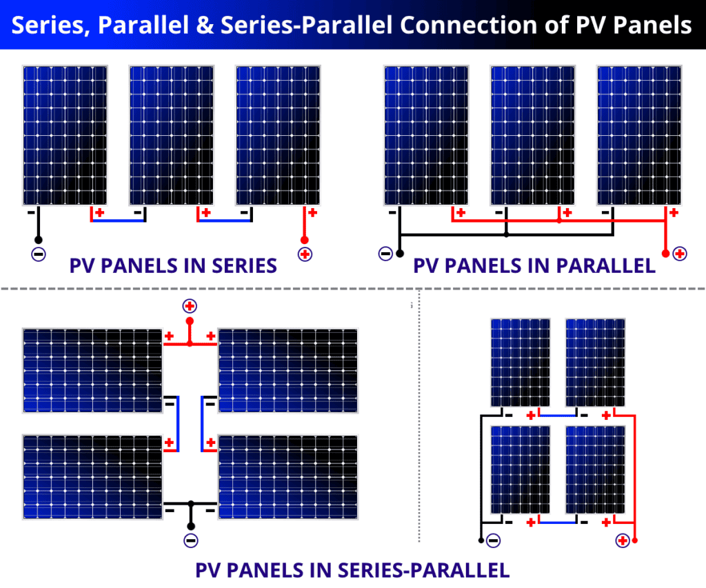

Connecting Solar Panels to an Inverter
There are three different methods of stringing solar panels together and connecting them to the solar inverter or charge controller (for off-grid and hybrid systems.)
(Source: Alternative Energy Tutorials)

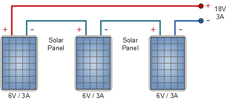

Connecting Solar Panels of the Same Model and Rated Power in Series
To connect your solar panels in series, wire the positive terminal to the negative terminal of each panel in the array. At the end, you’ll have a single positive/negative connection that will plug into your balance of system.
By wiring your solar panels in series, the output voltage of the array accumulates. In the diagram above, the output voltage of each panel is 6 volts. At the end of the series, the cumulative output is 18V (3 panels x 6V = 18V).
What’s crucial to note is that while the voltage output increases with each panel added to the series, the amperage remains the same.
Series connections are typically used for grid-tied systems that require a voltage of 24V or more.
Advantages
Voltage Accumulation: If your installation requires high voltage to operate — standard with on-grid systems — series or hybrid series/parallel wiring is probably essential. Even if it’s not, if your application is best served by higher voltage rather than amperage, a series connection is your best choice.
Efficiency and Performance: Without considering other factors, series connections will output slightly more electricity from the PV panel array than other wiring methods. There is less power lost delivering electricity over distance to your balance system in a series connection.
Thinner Cables: A relatively minor consideration, but parallel connections require higher gauge wiring due to how the electricity is transmitted. Series connections may cost slightly less to wire the same number of panels.
Better for Distance: Depending on the total surface area of your installation and how long the cables must be to connect to your balance of system, series connections may deliver an additional benefit. Voltage travels more efficiently than amperage over long distances.
Disadvantages
Obstruction and Shading: The most significant disadvantage of wiring solar panels in series is that the output of the entire array is dependent on the individual production of each module.
If you have 20 solar panels with a rated voltage of 6V each, the maximum potential output during peak sun hours is 120V. However, if just one module is in the shade (or damaged) and only produces 4V, the array’s output will be reduced to 4V per panel. Instead of 120V of production, your panels will output 80V. If part of your installation area suffers from significant shade during peak sun hours, you should consider parallel or hybrid connections instead.
Danger: High Voltage: There are many benefits to increasing the voltage output of your solar panel array. However, high voltage can be dangerous or deadly if improperly used. Working with high voltage also dramatically increases the risk for the person doing the installation. If you decide to proceed with a series connection, it’s best to hire a
professional installer.

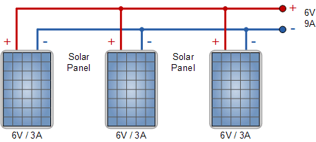

To wire solar panels in parallel, connect each panel’s positive terminals together. You also connect all the negative terminals to one another. Parallel wiring results in amperage accumulating and voltage remaining the same. The exact opposite effect of series wiring.
Again, using the same panels in the series example above, if the amperage per panel is 3V and you have 3 identical panels, your total output will be 9 amps (9A) and 6 volts (6V). The formula looks like this:
3A x 3 PV panels = 9A total output
Voltage doesn’t increase — the output remains 6V no matter how many solar panels you connect. If you have a 20-panel array connected in parallel with 6V/3A of rated power output, your maximum electricity production capacity is 6V/60A.

Series-Parallel Connections (Hybrid)
Connecting solar panels in series or parallel each has its pros and cons.
Can you have the best of both worlds?
Yes, many professional sizeable solar panel installations combine series and parallel wiring in one array to maximise the product of each group of panels.
It’s possible to strike the optimal balance between series and parallel wiring by carefully planning the wiring based on the location of the panels on the roof relative to the sun and obstacles that obstruct sunlight at certain times of day.
Typically, the goal is to achieve the right balance of producing volts and producing amps by wiring panels together in series and in parallel — not either/or.
If your residential solar installation will have more than 3 or 4 PV panels, it’s best to work with a professional installer. It will cost you more upfront but should substantially increase your return on investment and shorten your solar payback period.
For safety and performance reasons, we highly recommend that you DO NOT attempt hybrid series-parallel wiring of your solar panels on your own. Work with a reputable installer to achieve optimal results.

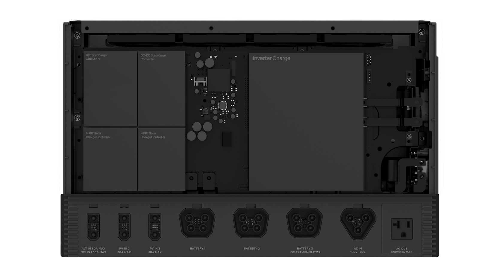

EcoFlow Power Kits and Power Hub
Trying to choose an inverter and other components can become confusing. You can never be quite sure about compatibility between solar panels, batteries, inverters, and charge controllers. That’s why some companies have put together convenient all-in-one off-grid power solutions.
The EcoFlow Power Kits are an excellent example of a plug-and-play off-grid solar power system. They are perfect for cabins, tiny homes, and RVs.
The Power Hub includes all of the essential converters, outlets, and chargers for an off-grid system, including:
- DC-DC Step-Down Converter
- DC-DC Battery Charger with MPPT
- MPPT Solar Charge Controller
- Solar Inverter Charger
With an all-in-one system, you don’t need to worry about compatibility and whether the inverter is the right type for your solar power system. The Power Kits also work with all models of EcoFlow solar panels (rigid, portable, and flexible) and panels from other manufacturers.
EcoFlow’s Power Hub: What’s in the Box?
A DC-DC step-down converter takes the high voltage of PV panels (often 50+ volts) and steps it down to the 48V that the EcoFlow Power Kit batteries expect.
The DC-DC battery charger with MPPT (multi-power point tracking) allows the battery bank to be charged directly by other DC power sources, such as a car alternator or a service battery.
An MPPT is especially useful in RV and other mobile applications. The technology allows for high-efficiency charging and is superior to similar chargers that use PWM (pulse width modulation) chargers.
The integrated MPPT charge controller allows for safe, efficient charging of your battery bank using the power generated by your solar array.
The inverter charger allows your system to charge and function using AC power. For example, with an RV installation, you can connect directly to shore power at campgrounds.
