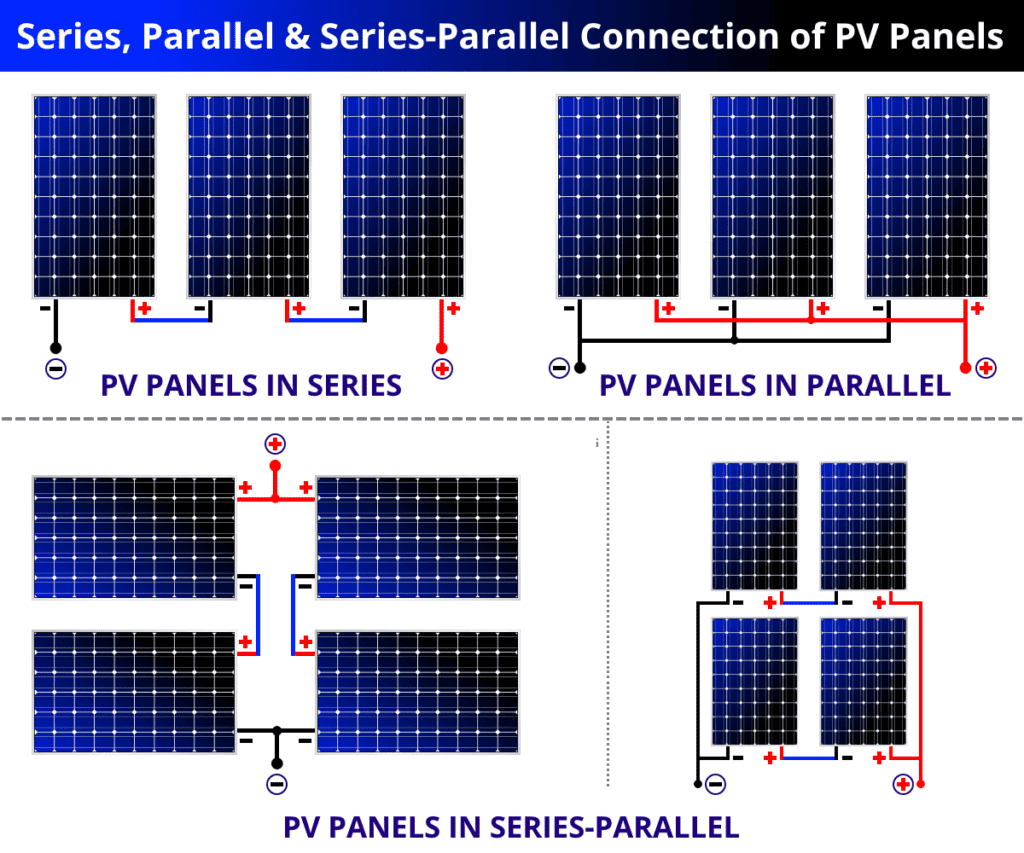

What’s the Difference Between Wiring Solar Panels in Series or Parallel?
In most modern solar panel arrays, the physical act of wiring multiple solar panels together is simple.
However, there is one essential decision you must make.
Given the layout of your solar panel array, the number of PV panels, and the electricity production outcome you’re trying to achieve, is it better to connect your panels in series or parallel?
Or a combination of both?
What does connecting solar panels in series or parallel mean?
It’s essential to note that wiring your series or parallel doesn’t automatically lead to increased power output.
In laboratory conditions, 2 x 400W solar panels wired in series will produce 800W of output.
The SAME 2 x 400W solar panels wired in parallel will produce the SAME 800W output.

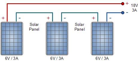

To connect your solar panels in series, wire the positive terminal to the negative terminal of each panel in the array. At the end, you’ll have a single positive/negative connection that will plug into your balance of system.
By wiring your solar panels in series, the output voltage of the array accumulates. In the diagram above, the output voltage of each panel is 6 volts. At the end of the series, the cumulative output is 18V (3 panels x 6V = 18V).
What’s crucial to note is that while the voltage output increases with each panel added to the series, the amperage remains the same.
Series connections are typically used for grid-tied systems that require a voltage of 24V or more.

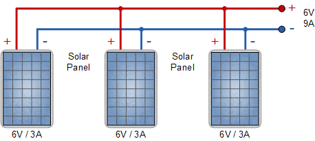

Connecting Solar Panels of the Same Model and Rated Power in Parallel
Parallel Wiring
To wire solar panels in parallel, connect each panel’s positive terminals together. You also connect all the negative terminals to one another. Parallel wiring results in amperage accumulating and voltage remaining the same. The exact opposite effect of series wiring.
Again, using the same panels in the series example above, if the amperage per panel is 3V and you have 3 identical panels, your total output will be 9 amps (9A) and 6 volts (6V). The formula looks like this:
3A x 3 PV panels = 9A total output
Voltage doesn’t increase — the output remains 6V no matter how many solar panels you connect. If you have a 20-panel array connected in parallel with 6V/3A of rated power output, your maximum electricity production capacity is 6V/60A.

Series-Parallel Connections (Hybrid)
Connecting solar panels in series or parallel each has its pros and cons.
Can you have the best of both worlds?
Yes, many professional sizeable solar panel installations combine series and parallel wiring in one array to maximize the product of each group of panels.
It’s possible to strike the optimal balance between series and parallel wiring by carefully planning the wiring based on the location of the panels on the roof relative to the sun and obstacles that obstruct sunlight at certain times of day.
Typically, the goal is to achieve the right balance of producing volts and producing amps by wiring panels together in series and in parallel — not either/or.
If your residential solar installation will have more than 3 or 4 PV panels, it’s best to work with a professional installer. It will cost you more upfront but should substantially increase your return on investment and shorten your solar payback period.

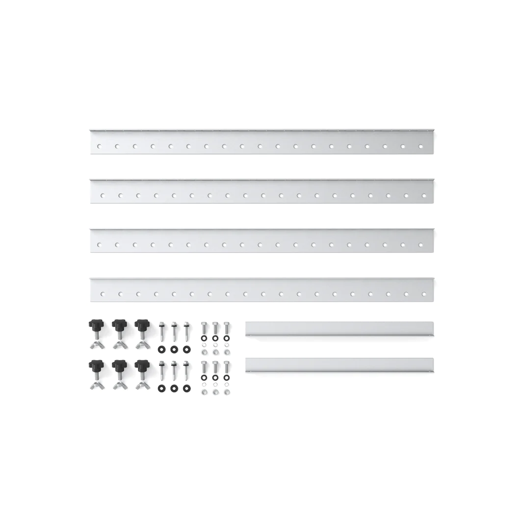

Step 3: Assemble Your Mounting Hardware
EcoFlow’s rigid solar panels come with 4 x solar mounting feet. But unless your roof is perfectly angled for maximum sunlight exposure, you will need additional hardware.
You can purchase optional EcoFlow 50” Tilt Mount Brackets directly from the manufacturer’s website. The 50” (127cm) Tilt Bracket is specifically designed to make mounting your 400W rigid solar panels on a rooftop (or any other flat surface) incredibly easy.
All you need is the following tools:
  • Adjustable wrench (M8 and M12)
  • Tape measure
  • Safety glasses
  • Work gloves
If you prefer a different method of mounting your panels, such as a racking system, EcoFlow 400W rigid solar panels are designed to work easily with most third-party mounting systems.
The Tilt Bracket is simply a painless option for mounting your PV panels and positioning them optimally on your roof.
Detailed assembly instructions are included with the brackets. Anyone with even minimal DIY experience can assemble this mounting hardware.
Just be careful up on the roof!

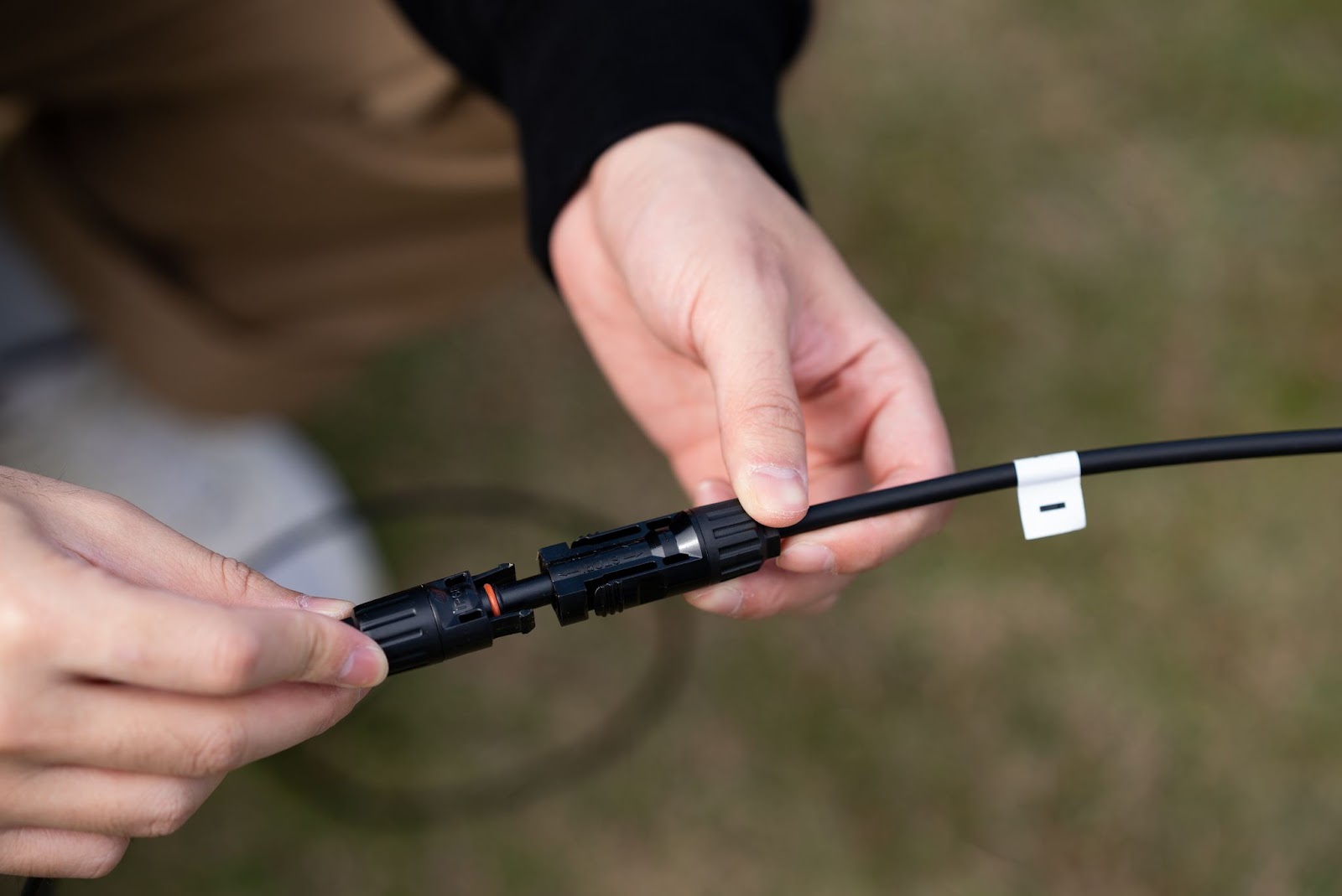

Series Connection

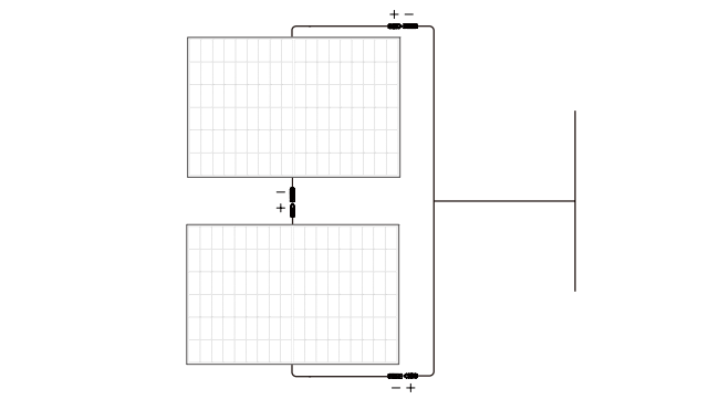

For series connection, connect the positive pole of one module to the negative second, third and fourth modules correspondingly. A series connection between 4 solar panels could quadruple the voltage. Amperage and wattage output remain the same.
For relatively small installations like this one, connecting the panels in series is recommended. Since the surface area required for installation is only 10m2, it’s unlikely that the performance of one solar panel will diminish the performance of the other 3 modules.
Parallel Connection

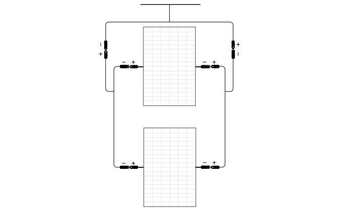

For parallel connection, please connect the positive and negative cables of one module and the second module correspondingly. A parallel connection between 4 solar panels could quadruple the amperage. Voltage and wattage output remain the same.
If you’re worried about the current being too low, consider wiring the four PV panels in parallel. With a four-panel array, there’s no benefit to wiring it in series-parallel.
