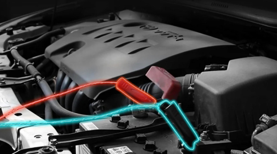

Jump-Starting a Car with Jumper Cables
Jumper cables transfer power from a donor vehicle to help start an engine with a flat battery. They provide immediate cranking power but do not fully recharge the battery. Follow both vehicle manuals and use any approved remote jump-starting posts where specified.
Use this connection sequence unless either vehicle manual gives different instructions:
  1. Attach one red clamp to the positive (+) terminal or approved positive post on the flat vehicle.
  2. Attach the second red clamp to the positive (+) terminal of the donor vehicle.
  3. Attach one black clamp to the negative (-) terminal of the donor battery.
  4. Attach the final black clamp to the flat vehicle’s designated chassis ground point. Use a solid, unpainted metal point away from the battery, fuel lines and moving engine parts. Do not connect this clamp to the negative terminal of the flat battery.
Start the donor vehicle and let the engine run briefly before trying to start the flat vehicle. Stop after a few unsuccessful attempts and contact roadside assistance, as repeated cranking can overheat the starter and cables.
Once the engine starts, remove the clamps in reverse order:
  1. Remove the black clamp from the flat vehicle’s chassis ground.
  2. Remove the black clamp from the donor battery.
  3. Remove the red clamp from the donor battery.
  4. Remove the red clamp from the recovered vehicle.
Keep the clamps apart throughout the process. Recharge the battery with a compatible charger or arrange a battery test if it loses power again soon afterwards.
