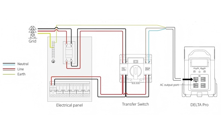

2. Installing a Transfer Switch
A transfer switch is a dedicated electrical device that safely connects your generator to your home’s electrical system. It allows you to switch your home’s power source from the utility grid to your generator and back again. This ensures that your generator does not back-feed power into the utility lines, which is a dangerous condition for utility workers.

Step 5. Connect and power up
Properly connect both ends of the generator wires to the inlet box hookup and the household cable. Check the oil level, start the engine, and run it for about 5 minutes. Then, switch from the mains to the generator power and switch the circuit breakers on your installed system. Finally, turn on all loads one by one. Your generator should now be able to power your home.
Connect a generator to a house
