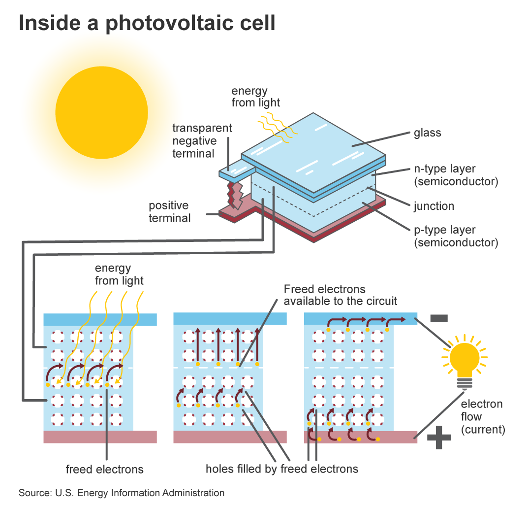

How Does a Wafer-Based Solar Cell Function?
A wafer-based solar cell is a unique type of non-mechanical semiconductor that uses a p-n junction to produce the photovoltaic effect — transforming photons from sunlight into direct current electricity.
Semiconductors are an essential component of almost all modern electronic devices and appliances and fall under two classifications.

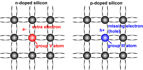

Extrinsic semiconductors are made by intentionally introducing chemical impurities that improve the electrical properties of a purified material like silicon.
Adding tiny amounts of chemicals like boron and phosphorous to purified silicon is called doping.
Purified silicon is used to make extrinsic semiconductors — like those used in solar cells.
However, the conductivity of intrinsic semiconductors is too low and sensitivity to temperature too high to perform adequately in modern electronic devices.
Only by adding dopants to intrinsic semiconductive materials can we manufacture the extrinsic semiconductors found in virtually every electrical device, from transistors and diodes to microchips and solar panels.

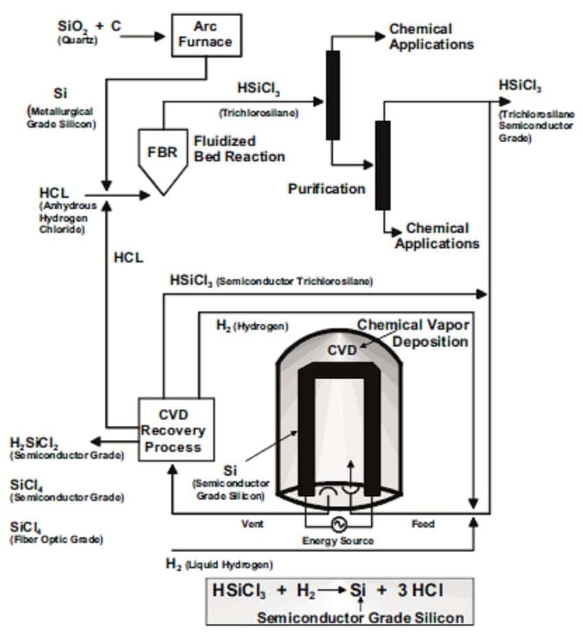

The most widely used purification method for solar-grade polysilicon is known as the Siemens Process.
(Source: ResearchGate)
The Siemens Process
Multiple attempts have been made to develop less costly and more efficient methods of producing solar-grade polysilicon, but the Siemens Process remains the most widely used.
The process was developed in the 1950s and is still used to produce an estimated 90% of the total volume of polysilicon used to make solar wafers and semiconductors for electronics.
The primary raw material (feedstock) for the Siemens Process is metallurgical-grade silicon (MG-Si).
MG-SI is ~98.5% pure.
The Siemens Process purifies MG-Si still further to produce solar-grade polysilicon.
Here are the basic steps.
  1. Metallurgical-grade silicon is crushed into a fine powder.
  2. The MG-Si crystals are fluidised with hydrochloric acid (HCI) in a distillation column to produce liquid trichlorosilane (SiHCl3 or TCS).
  3. In a steel bell jar reactor, trichlorosilane is deposited onto pure silicon filaments that are electrically heated up to 2,102°F (1,150 °C). This is known as chemical vapour deposition (CVD).
  4. The end product of CVD is purified polysilicon rods with a diameter of 15 to 20cm grown in the reactor. Byproducts like silicon tetrachloride (SiCl4, or STC) are recycled through hydrochlorination and fed back into the beginning of the process.
(Source: ReseachGate)

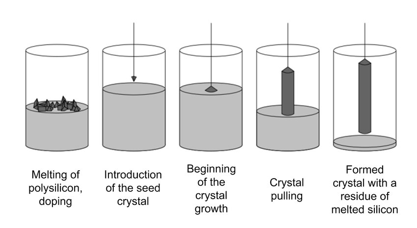

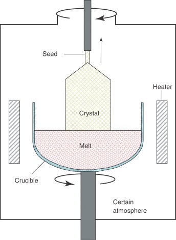

The Czochralski technique grows pure monocrystalline ingots by melting chunks of polysilicon rods as feedstock in a cylindrical quartz crucible fused from high purity Silica (SiO2).
Quartz crucibles are capable of withstanding extreme heat of up to ~2640°F (1450°C).
The polysilicon feedstock is melted in the crucible at a temperature of around 2600°F (1420°C).

Doping with boron creates N-type (negative) silicon. Phosphorous doping produces P-type (positive) silicon.
A P-N junction produces the photovoltaic effect and converts the photons from sunlight into DC electricity.
(Source: ScienceDirect)
Seeding the Silicon
A single pure silicon seed crystal is dipped into the molten silicon feedstock.
Seed crystals for solar-grade wafers are, at most, a few millimetres in diameter.
Once the seed crystal is inserted, a melt meniscus is formed.
The seed crystal is then slowly withdrawn.

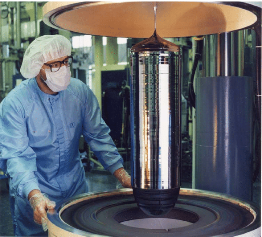

Pulling Silicon
“Pulling” the silicon from the crucible is one of the most critical steps of the Czochralski process.
How the silicon is pulled determines many aspects of the end product, including the size of the ingot and wafers.
The following aspects of pulling silicon are precisely controlled:
  • Individual rotation rate of both crucible and seed
  • Heat application
  • Pulling velocity

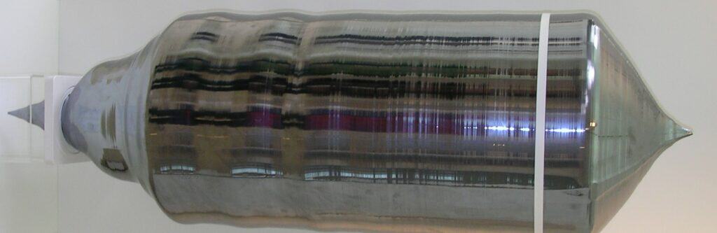

Once the pulling process is complete, the end product is a monocrystalline silicon ingot — ready to be turned into wafers for photovoltaic cells.

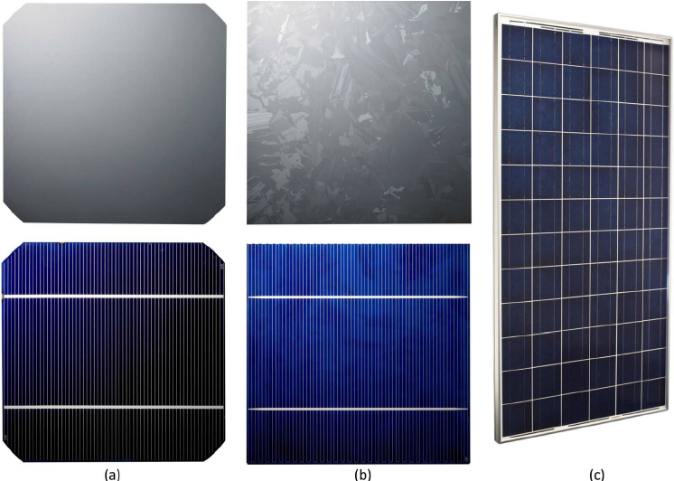

Once the rod has been sliced, the circular silicon wafers (also known as slices or substrates) are cut again into rectangles or hexagons.
Two types of silicon wafers for solar cells: (a) 156-mm monocrystalline solar wafer and cell; (b) 156-mm multicrystalline solar wafer and cell; and (c) 280-W solar cell module (from multicrystalline wafers)
Cutting circular silicon wafers into polygons doesn’t change their electrical properties or utility as a semiconductor material.
In fact, this step is unnecessary in many applications — including most microchip manufacturing.
It’s entirely possible for solar cells to be circular.
However, you can fit more rectangular PV cells in a solar panel.
Polygonal-shaped wafers help simplify the manufacturing and assembly of PV modules comprised of multiple solar cells.

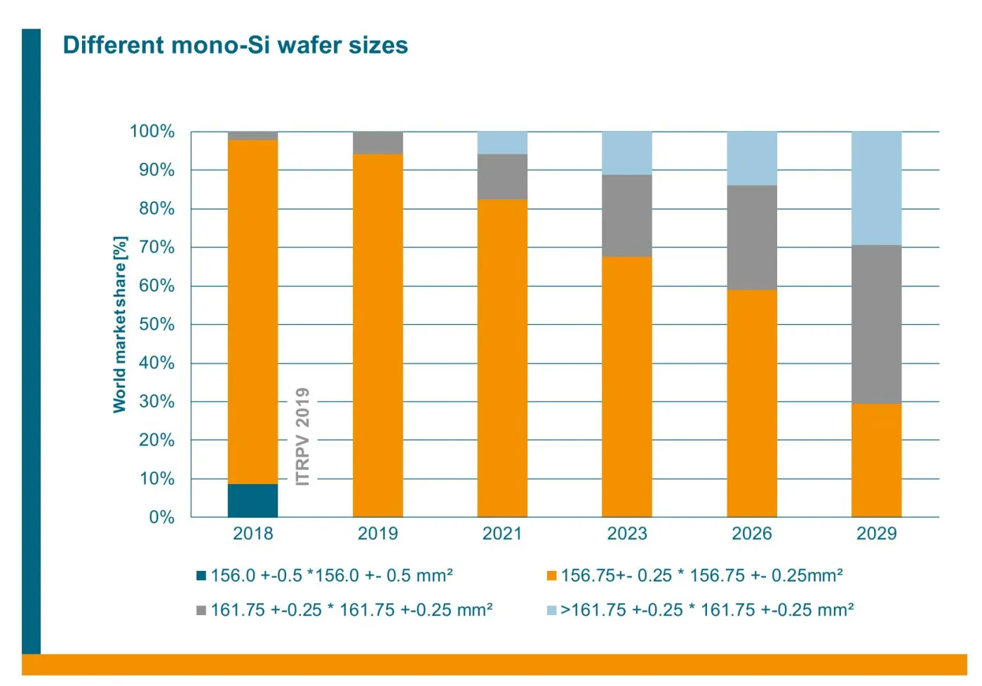

Monocrystalline Solar Wafer Sizes
Traditionally, the standard size for solar wafers has been 156mm2 — classed as MO.
In recent years, the diameter of silicon wafers manufacturers use for high-efficiency solar cells has increased — and so has the performance.
Wafers as large as 210mm2 (M12) are increasingly used in PV cells  — a 35% increase in diameter from the original M0.
Much of the cost of manufacturing solar panels comes from the silicon wafer production process.
By increasing the size of the silicon wafers, manufacturers can produce photovoltaic cells that produce more rated power wattage without significantly raising costs over the long term — a win-win for factories and consumers.
