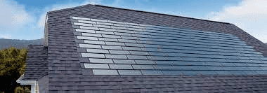

What Are Solar Shingles?
Solar shingles utilise photovoltaic cells to capture the sun’s rays and a balance of system to convert solar energy into electricity. Shingles work the same way as PV solar panels but are designed to look and function like traditional slate or asphalt shingles.
Instead of using mounting hardware and frames to install solar shingles — as is common with rooftop solar panel arrays — they are embedded into the roof during construction and replace conventional shingles. For this reason, solar shingles are also known as Building-Integrated Photovoltaics (BIPV).
Because solar shingles are integrated into a home’s structure, they are typically more suited to new builds or when replacing an old roof. Solar panels are much easier to retrofit onto an existing building.
Solar shingles serve the dual purpose of protecting your home against the elements and providing electricity to power your home. Solar shingles can even be more durable than traditional roofing materials like asphalt and may last longer before needing to be replaced.
Since PV shingles are embedded into your home’s roof, they may be less likely to dislodge during a wind storm or be damaged by hail and other extreme weather events than PV panels.
On the other hand, they’re also significantly less efficient — and more expensive to purchase and install — than a rooftop solar panel system.

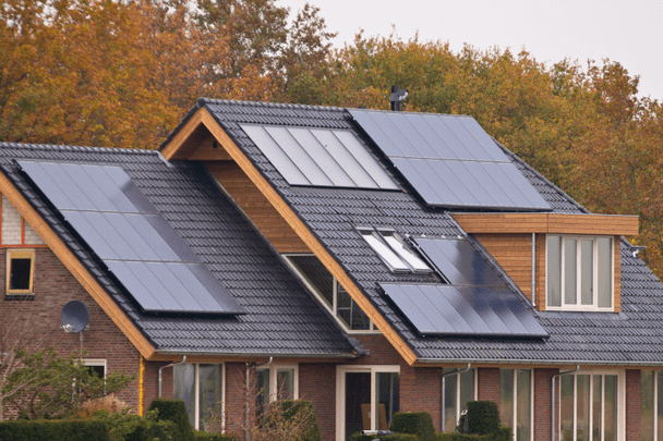

What Are the Differences Between Solar Roof Shingles and Solar Panels?
| Solar Panels | Solar Shingles | |
| Average Size per Unit | 39 inches by 65 inches (990mm x 1,651 mm)  | 12 inches by 86 inches (300 mm × 2,180 mm) |
| Average Cost of Residential Solar Array | $5,000 to $35,000 (USD) | $63,000 to $75,000 (USD) |
| Photovoltaic Material | Silicon | Copper indium gallium selenide or monocrystalline silicon |
| Output (per unit) | 100-400W | 13-70W |
| Appearance | Blue or Black Color | Black |
| Average Efficiency | Up to 23% | 14-18% |
Size
At 12 inches by 86 inches (990mm x 1,651 mm), the average photovoltaic shingle has a smaller area than a panel. A single rigid solar panel can be 68 x 45 inches (1,722 mm x 1,134 mm).
PV shingles are also significantly thinner and lighter, adding less weight to your roof.
On the other hand, because PV shingles are less efficient, you will likely need more space for a complete installation than you would for panels.

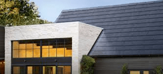

Aesthetics
Solar panels are mounted on your roof, while the shingles are integrated into the building itself. Shingles are sized and shaped to blend into the roof visually. The black colour works well for most roof designs.
For this reason, many people find PV shingles more aesthetically pleasing than rooftop panels.
The price you pay for aesthetics isn’t cheap. But it may be worth it to you. It may also be the only solar option if you’re part of a homeowners association (HOA) with rules about what you can install on your roof.

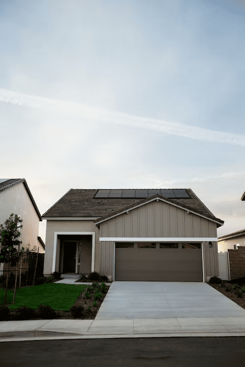

How Much Does It Cost To Install Solar Shingles?
Installation and purchase of PV shingles is substantially more expensive than installing PV panels. In the US, a solar shingle array typically runs between $60,000 and $75,000.
In other countries, the price tends to be even higher — partly due to less widespread options.
The average cost above includes the cost of 300-350 solar shingles, as well as labour for installation.
To defray these costs, it’s best to install them when you’re building a new home or replacing your existing roof. This can bring the cost more in line with what you would already pay for roofing installation and materials.
Depending on your circumstances, a rooftop replacement may drop your homeowners’ insurance cost.
If you’re considering a permanent solar shingle or panel solution, don’t forget to check your eligibility for government tax rebates and other incentives. Reducing reliance on fossil fuels and switching to clean renewable energy sources like solar is a global imperative — for citizens and governments.

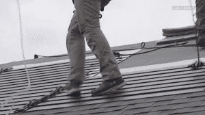

How To Make the Switch From Solar Panels To Solar Roof Shingles
Switching from solar panels to PV roof shingles is demanding and expensive. After taking down the solar panels, you need a professional installer or roofer to remove your current tiles and install the shingles one at a time. The process includes making the connections between tiles and connecting the entire array to your balance of system.
Because this process is so arduous, PV shingles make the most sense when you’re ready to replace your existing roof. It brings the cost more in line with regular roof replacement costs.

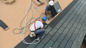

The process of installing solar shingles on an existing roof is extremely complex. Installation includes fitting the shingles into place, connecting them, and connecting the entire array to your balance of system. You’ll need to hire professional installers, and the time and labour costs will be high. Solar shingle installations are best suited for new construction and replacing an existing roof. Solar panels are much simpler to retrofit on your home’s existing roof.
