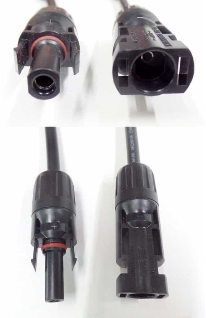

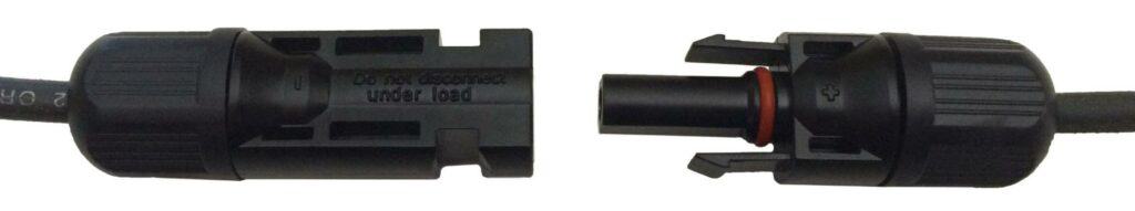

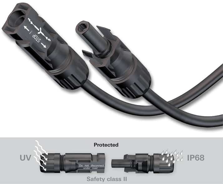

Universal Solar Connectors: The Industry Standard
Universal Solar Connectors are the current industry standard for solar panel systems, offering a reliable and secure connection between solar panels and other components in a PV system. Used in all EcoFlow’s solar panels, they are weatherproof, UV-resistant, and durable against harsh weather. They ensure a stable connection throughout the lifetime of a solar array.
There are male and female versions, both of which establish a proper connection while avoiding reverse polarity. They have a simple push-in and lock mechanism that provides a secure connection, reducing the risk of accidental disconnections.
Due to their safety, reliability, and compatibility with various solar components, Universal Solar Connectors are used in virtually all modern solar panel arrays.

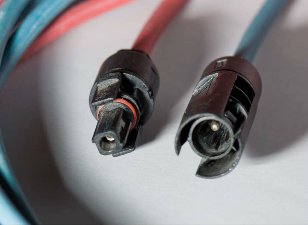

MC3: An Obsolete Technology
MC3s are an older generation of solar panel connectors. They were once popular, but Universal Solar Connectors have largely replaced them. They feature a snap-in locking mechanism that is less secure than the newer locking system.
MC3s also tend to be less weather-resistant and more prone to corrosion and wear over time. While they are still present in some PV installations, MC3s have become less common due to the superior performance, safety, and reliability of Universal Solar Connectors.
If you have a system older than ten years, it may be time to examine the connectors and upgrade them to the industry standard.
