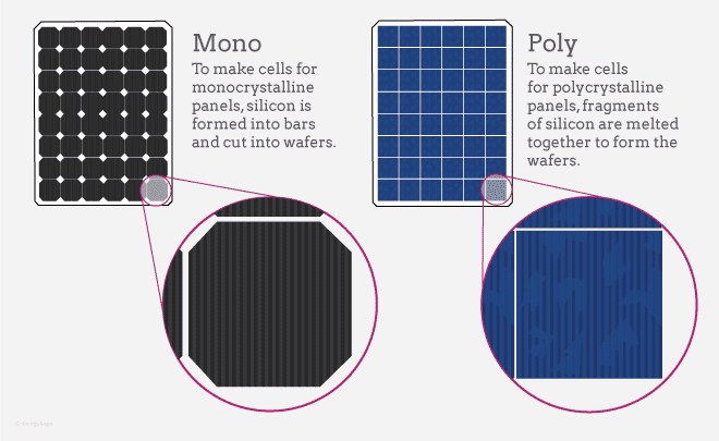

Let’s explore the differences between monocrystalline and polycrystalline PV cells.
(Source: ResearchGate)
Monocrystalline Silicon
When it comes to efficiency, monocrystalline solar panels win hands down.
Unlike polycrystalline PV cells made from melted silicon fragments, the solar wafers used to manufacture monocrystalline PV modules are cut from an ingot made from a single crystal of lab-grown silicon.
The purity of the material enables the cells to generate more electricity per square meter from the same amount of sunlight.
Because the manufacturing process requires more energy and raw materials, monocrystalline solar panels are also more expensive to produce.
However, with efficiency ratings as high as 23% vs 13-18% for polycrystalline, electricity bill savings and the reduced surface area required for installation often more than offset the higher upfront cost.
With their distinctive black appearance, monocrystalline solar panels are also more aesthetically pleasing and blend in with any home design or roof.
Polycrystalline Silicon
If solar panel efficiency isn’t a concern, polycrystalline solar panels tend to be cheaper than monocrystalline PV modules.
Polycrystalline silicon PV cells are less expensive and time-consuming to produce.
However, any savings you make on price will likely be outweighed over the long term by inferior performance.
Instead of pure silicon wafers, polycrystalline PV cells are made from the fragments of many silicon crystals fused together by heat.
The waste product from manufacturing is recycled, leading to less wastage than with mono panels.
By eliminating some of the time and materials required to manufacture monocrystalline silicon, poly PV panels come at a lower retail price.

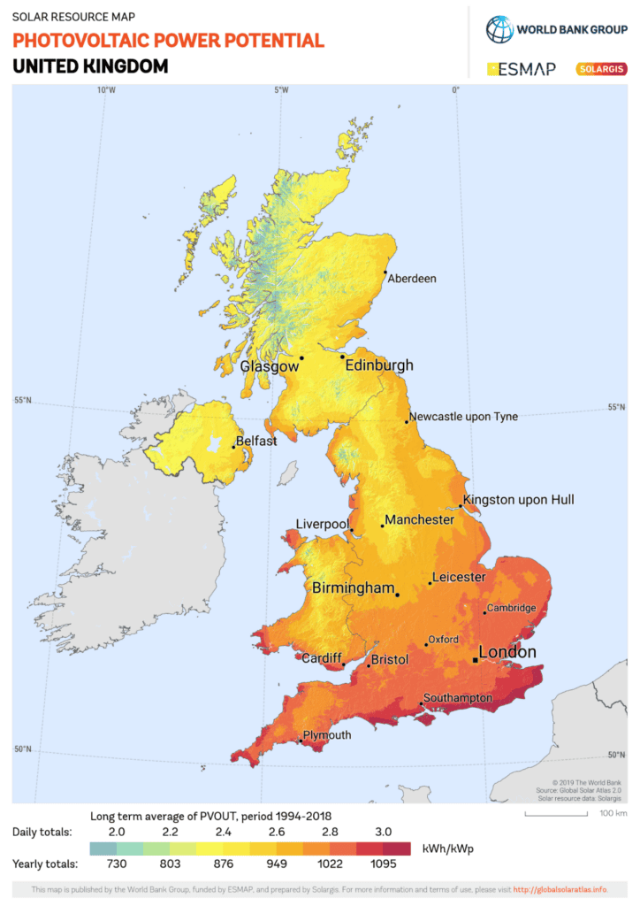

Solar Resource and Potential
Even with all of today’s forecasting technology, it’s impossible to predict with certainty how much electricity any given solar panel array will produce tomorrow.
However, historical records of how much sunlight a location receives have been kept for years and provide an invaluable tool for forecasting solar resources and potential.
The map above shows the estimated photovoltaic power potential for each region in the UK.
As you can see, the south of England receives significantly more peak sunlight on average than the north.
More detailed estimates by location are easy to find.
Once you know how many peak sun hours you can expect in your area, you can begin calculating how much electricity output you should be able to achieve from any given solar panel.

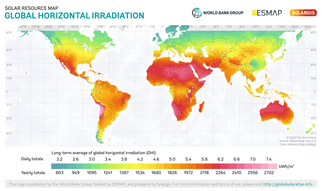

(Source: Global Solar Atlas)
Global Horizontal Irradiance
Global Horizontal Irradiance (GHI) is the scientific term for a measurement that integrates Direct Normal Irradiation (DNI) with Diffuse Horizontal Irradiation (DHI), which is a fancy way of saying it shows the average sunlight by location based on past measurement.
The terms GHI and solar potential are used somewhat interchangeably.
Either one can help forecast the average expected sunlight at your location.

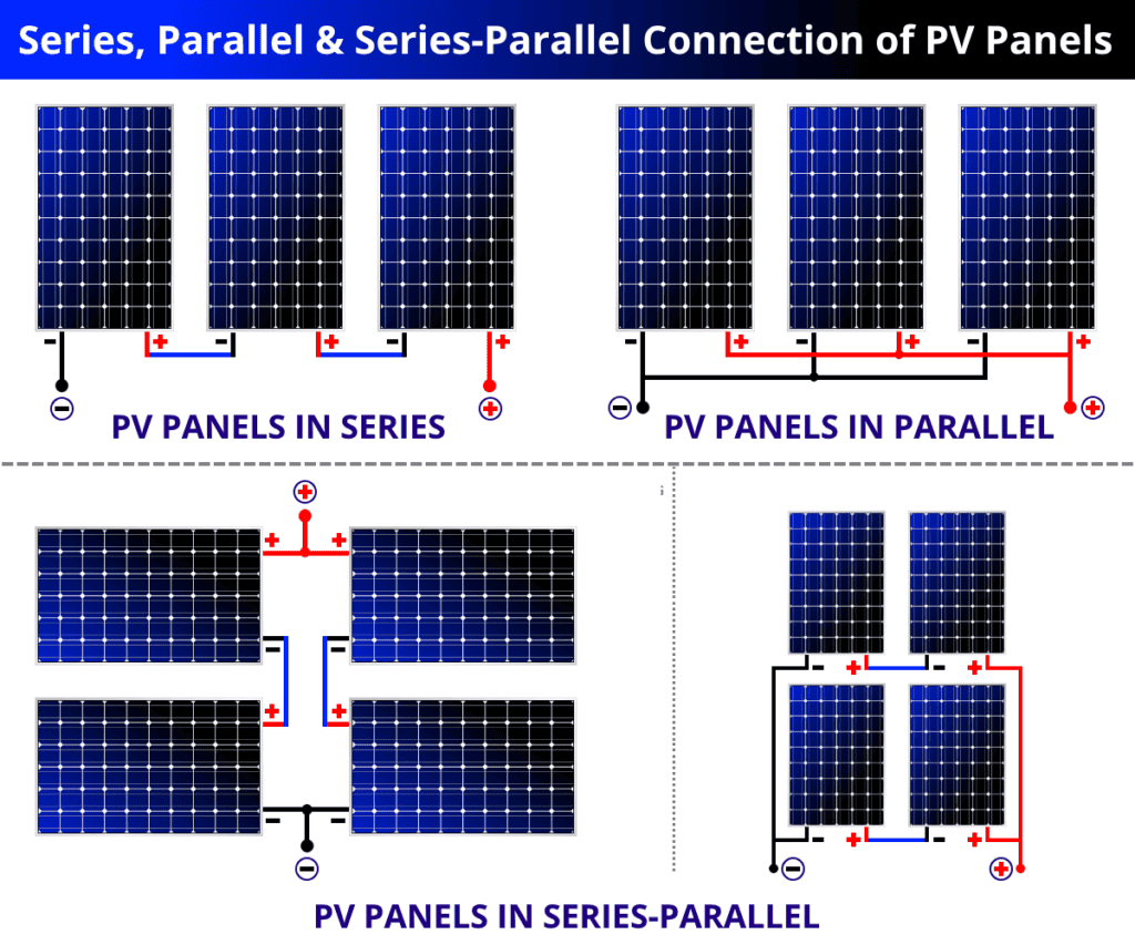

Series, Parallel or Hybrid?
If you’re installing more than one solar panel, you have a crucial decision to make.
Should you connect the PV modules together in series, parallel or a hybrid of both?
The correct answer depends on numerous factors, including:
- Solar input capacity of your inverter in volts, watts, and amps
- Number of PV panels
- Environmental conditions during the day, especially shade
Connecting solar panels in series increases the combined output voltage of the array, while parallel connections increase the current while voltage remains constant.
In laboratory conditions, the total output wattage of a PV module array won’t increase no matter how you connect the panels.
