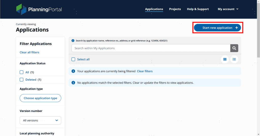

3. Planning application for exceptions:
Link to the application please find below:
https://www.planningportal.co.uk/app/applications
