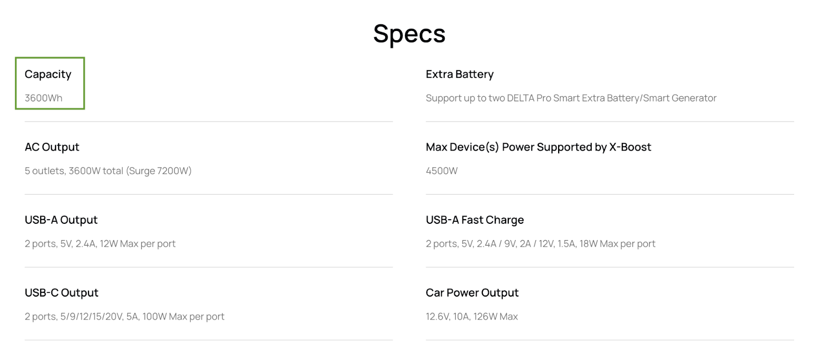

Capacity indicates the maximum amount of electricity a portable power station can store in its battery when fully charged. If you allow your portable power station to discharge completely before recharging, the capacity is the maximum amount of electricity you can consume. Battery storage capacity is measured in watt-hours (wH) or kilowatt-hours (kWH) — just like you’ll find on your electricity bill.Portable power stations can operate while recharging – for example, when using solar panels. You don’t have to wait for the battery to recharge for the PPS to function. Additionally, every current EcoFlow portable power station (except the DELTA Max) uses LiFePO4 battery chemistry, which supports deep cycles (fully charging/discharging) without nearly as much impact on performance and lifespan as other battery types.

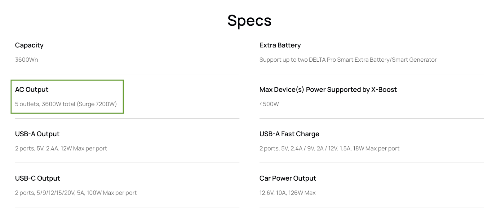

AC Output indicates the maximum number of watts (electricity) the portable power station can deliver on-demand simultaneously. If any appliance you want to operate exceeds the AC output, the PPS can’t run it. Similarly, the total wattage of all the appliances you want to operate at the same time can’t exceed the maximum AC output — in this case, 3600W.
Surge Power: Many high-wattage appliances require more watts to start than they do to run. The starting and running watts on most devices will be listed on the manufacturer’s label. If listed, the starting wattage will always be higher than the running wattage — sometimes up to double.It’s crucial to consider the starting wattage requirements of the appliances you want the PPS to run. If they exceed a PPS or generator’s maximum surge power, you won’t be able to turn them on. All of EcoFlow’s portable power stations offer proprietary X-Boost technology, which provides a short burst of up to double the AC output to get high-wattage appliances up and running. DELTA Pro can deliver surge power (starting wattage) of up to 7200W.

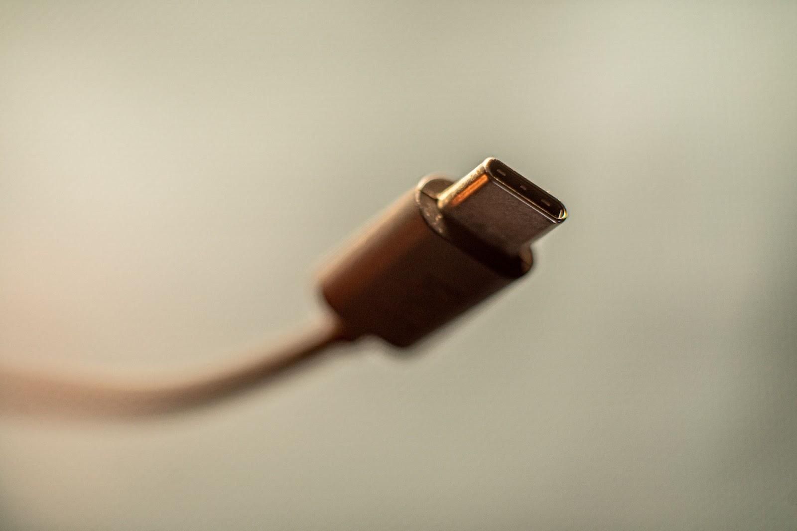

USB-C Output refers to the number of USB-C ports on the device, the combinations of volts and amps supported, and the maximum watts per port.
USB-C cables are used to charge most modern smartphones and many other personal electronic devices. According to MakeUseOf: “More than 700 technology companies, including Apple, Google, Intel, and Microsoft, collaborated on USB-C’s initial design and adoption. USB-C is truly universal and will not fade into obscurity.”Again, this spec indicates the number of ports and the electricity output for each.
