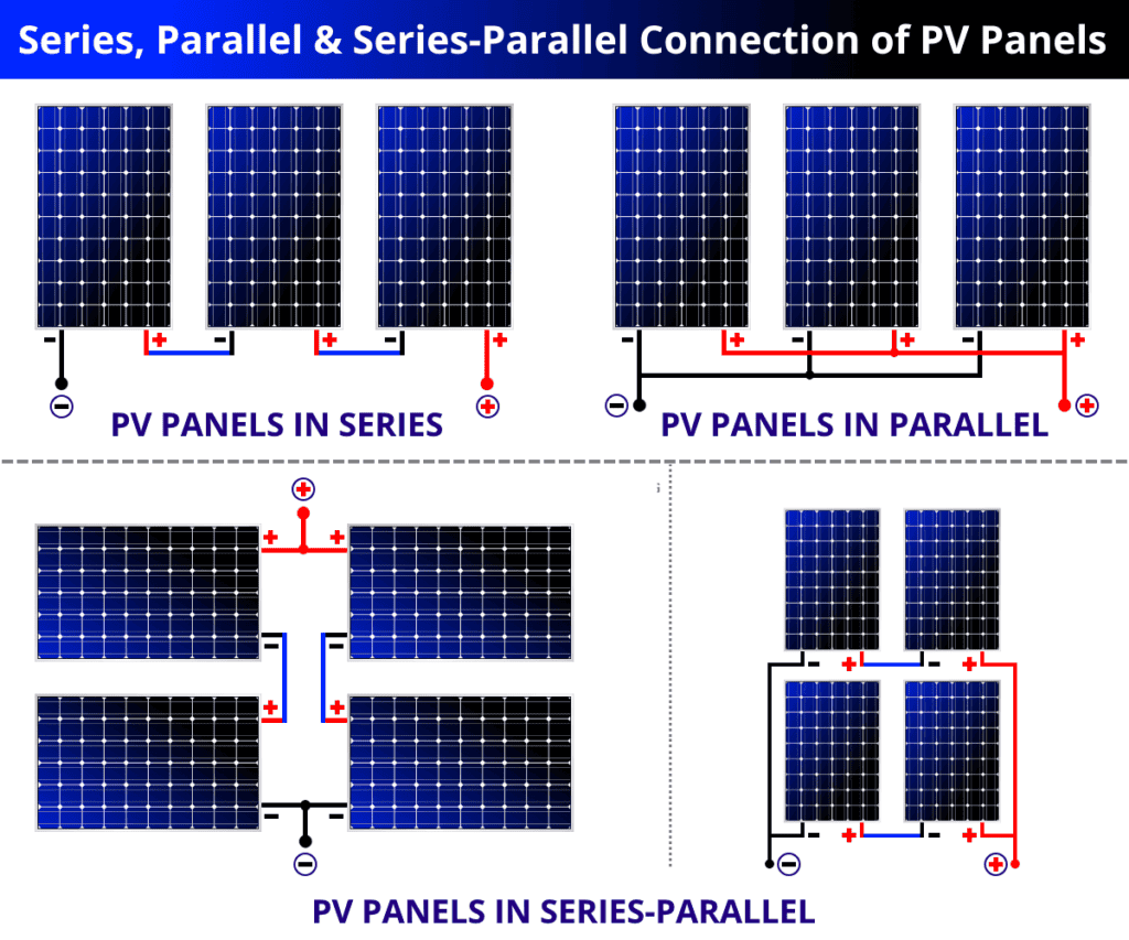

Connecting Solar Panels in Series vs. Parallel. What Is the Difference?
In most currently available solar panel arrays, connecting multiple solar panels to each other is simple.
Most solar panels use a Universal Solar Connector, and many manufacturers provide the necessary cables to wire numerous modules together.
However, it’s essential to understand that there are two options for connecting multiple PV panels.
Should you connect your solar panels together in series or parallel?
Or a hybrid of both?
The right answer depends on the number of PV modules, the planned layout, and your electricity generation goals.
So, what’s the difference?
  • Series wiring increases the sum output voltage of a solar panel array but keeps the amperage the same
  • Parallel wiring increases the sum output amperage of a solar panel array while keeping the voltage the same.

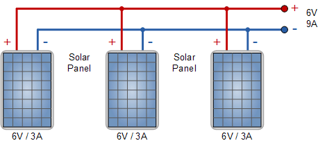

Parallel Wiring
Connecting solar panels in parallel requires wiring each panel’s positive terminals together and then all the negative terminals to each other.
Essentially, the opposite of series wiring, with parallel, amperage accumulates and voltage stays constant.
Using identical panels to the series wiring diagram, the amperage per panel is 3V.
The total DC output will be 9 amps (9A) and 6 volts (6V).
This is the formula:
3A x 3 PV panels = 9A total output
The voltage stays the — the DC output remains 6V no matter how many solar panels you connect.
If you have a 10-panel array connected in parallel with 6V/3A of rated power output, your maximum DC output potential is 6V/30A.
