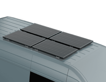

3. Mount the Solar Panels
The mounting process differs depending on the type of panels you have. You must install rigid panels with screws by drilling holes into your roof. They can either be affixed flat or tilt-mounted on the roof.
However, you don’t have to drill holes in your motorhome roof to install solar panels. Flexible designs can be mounted with adhesive attached directly to the roof surface.
Additionally, you can find removable types like EcoFlow Portable Solar Panels, which have a foldable design and portable carry case. They require no installation and are easy to set up.
You’ll need to drill holes if you opt for rigid solar panels with a fixed mount. Next, bolt the brackets tightly based on the positioning of your panels. Apply sealant underneath the brackets to keep an air-tight seal and prevent potential roof leakages.
Attach the solar panels to the fixed mounting hardware.

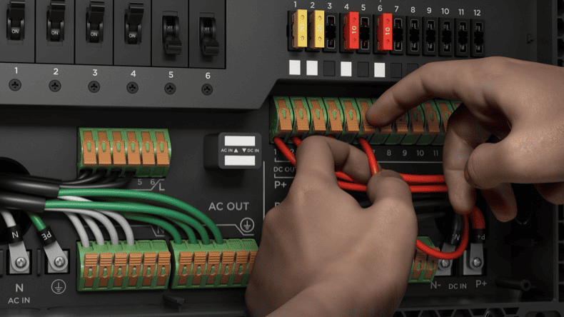

7. Connect Wires to the Fuse Panel
Once you’ve run wires throughout the motorhome for DC appliances, it’s time to connect them to the fuse panel.
You can use a wire stripper to expose the wire and remove the protecting coating. Then you can crimp terminal heads onto the wires using a crimping tool. The metal bends around the wire to hold it in place.
You connect the heads to the fuse panel, which should have the negative and positive connections labelled.
From there, add a fuse to the positive section. The fuse protects from power surges.
8. Connect Fuse Panel to Power Station
The easiest way to connect your fuse box to the power station is to use a cable with a car adaptor plug on one end and wires with a positive and negative attachment for the fuse box on the other.
Connect the wires to the fuse panel first. Then plug the other end into the power station and turn it on.
