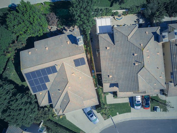

Your roof pitch will direct solar panels toward the sun at different times of the day. Choosing the right side of your roof can mean a difference of several hours of peak time for your system to absorb. Your solar panel positioning should also avoid shade from nearby trees and structures that prevent sunlight from hitting the panels at optimal levels.

As you determine the kind and number of solar panels for your array, you must consider your roof space. While a smaller house typically requires less energy, this is not always the case. A smaller roof may allow for smaller or fewer panels. Measuring your available space can help identify limitations and determine if you require higher-rated power options for your solar panels.
